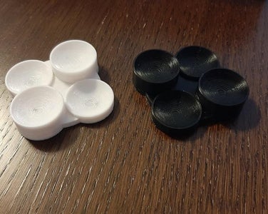

- 3d printed mold: you can get my design here: ~10€

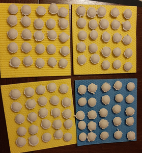

- Form small clay balls;
- Put plastic wrap on both molds
- Press hard so each stone easily detaches from excess clay. Watch out for excess clay: in the photo above, you can see some stones have protruding clay. You should avoid that.
- Lay them on the cloth / towel to avoid making them deform under their own weight.
- Wait for stones to be completely dry before going to next step (this could take up to 2 days)
