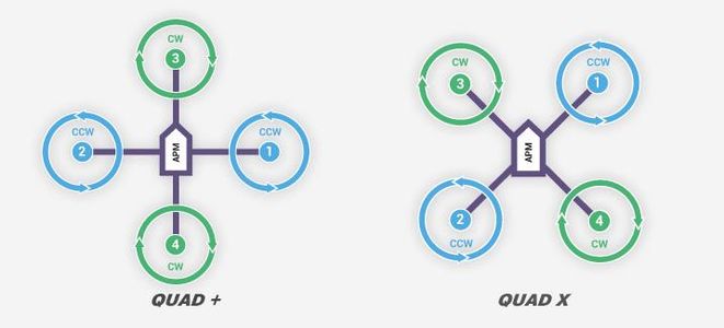

Just assemble your chosen frame and make sure that everything is symmetrical. The frame should be in either a cross or plus shape also this ensures equal distance from each motor so the propellors do not interfere with each other.
When the motors and ESCs have been mounted on the frame, connect all the negative and positive wires using a soldering iron.

Step 4: Check Motor Directions
Depending on what type of shape you decided to use, config your motors to spin in that direction. To change the direction of the motors you simply have to change the position of ANY 2 of the 3 connectors of the motor to the ESC.
