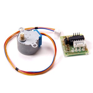

28BYJ-48 Stepper Motor with ULN2003 Driver Board
£1.99 on Amazon UK or $2.99 on Amazon USA

To create the stirring effect we are using a stepper motor, I've opted for the 28BYH-48. These motors are manufactured in large volumes so they are so cheap they're practically giving them away. They are known for missing the occasional step so not great for high precision tasks, but they are small and provide a lot of torque thanks to its 64:1 gear reduction ratio. You can read more about this motor here. The motor is commonly supplied with a ULN2003 driver, which is perfect for using with our PICAXE. The motor control is covered in more detail in the next step when we program the PICAXE.
Connecting the Stepper Motor to the ULN2003 Driver Board
The motor has a 5-way connector that simply fits into the header on the driver board, the cable is a little longer than we need but not enough to cause any issues.

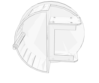

Now that you have the electronics, lights, motor and battery all prepped we are ready to assemble. Included is an exploded diagram of the assembly pieces, you should be able to work out how it all goes together by following the images, but I'll take you through it step by step as well. I printed all of my 3d parts using 50% infill and a 0.1 layer height, but you will get away with a lower infill and a greater layer height. As long as the water tanks remain water tight you will be fine, there is no physical stress placed on any of the parts when in use.
Tip:If you don't have access to a 3d printer you can simplify the mechanical assembly by salvaging a large cog or wheel from a scrap printer. Fix this to the motors drive shaft then glue on your spoon, simple!

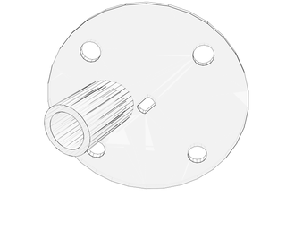

Motor and Drive Plate Assembly

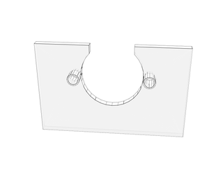

- First you'll want to fix the step motor to the motor assembly plate, this is done using the M3 screws and nuts.
- Fix the motor assembly to the main enclosure, it sits on the shelf supports and superglues in place.

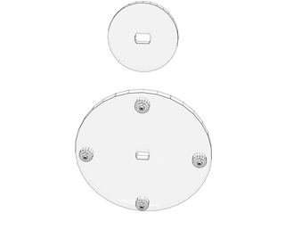

- The drive plate assembly consists of two pieces that are glued together. Make sure that the centers are aligned to allow the motor shaft to fit. You may need to use a countersinking tool to make a recess in the base of the smaller plate, this will allow the assembly to slide further down the motor shaft if necessary.
- The drive plate assembly push fits by slotting onto the motor shaft.

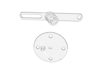

Stirring Actions
Choose one of the three stirring action pieces and slot it onto the drive plate. Line up the four pins and it should slot on securely. If the fit is too tight, use a round file to make the holes on the action plate a little larger.
Note that Stirring action three consists of two pieces, the round plate and the arm. The slotted section of the arm sits in the pin located at the front of the enclosure, while the hole fits onto the round plate's pin.
Water Tank
The crescent shape on the front of the enclsoure is a water tank, it also has a Max Fill level marker for your reference. This can be used for the purpose of adding a fog effect to your cauldron with the aid of some dry ice (more on this in the next step). Included with the STL files is the water tank assembly. This consists of a removable tank that has a carry handle to make filling and emptying easier. Just glue the handle bar in place and it can be used to lift the tank in and out.
