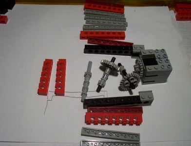

Step 2: Gear Train
The Lego motor spins at roughly 360 rpm which is quite slow so in order to speed this up we utilize a gear train. Below is a picture of the assembly. The end of the gear train is on the upper left and it will be the part that is attached to the spinning magnet bar.

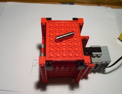

Step 3: Build a Frame
You want to build a frame to support a cup so in this design I built it using Lego pieces. What is important though is that your frame is sturdy enough to hold a cup with liquid and has some clearance for the spinning magnet mechanism. I used a Lego connector that looks like a T shape to attach the magnet onto the gear train. I also used some tape to secure it. When the setup is complete you should be able to place the bar magnet on top and it will lock into place. I chose neodymium magnets because they were strong.
