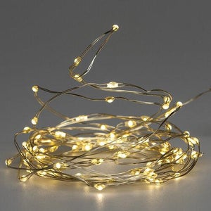

  • LED diode - many alternatives my fav. is one from the led chain, they have thin long insulated cables

  8. You can use led from the led chain
