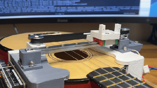

Step 4: Top Half Assembly
Start by placing the linear rail mount on the top half and secure it with M3 screws. The underside of the shell has a slot designed to allow the M3 nuts to be tightened.
Repeat this process to attach the stepper mount on the side, and then slide the stepper into position facing upwards.
Step 5: Bottom Half Assembly
For the bottom half, begin by installing the idler holder, followed by another rail mount. Next, attach the Arduino with the motor shield to the side.
The finished result should be similar to the pictures shown above.

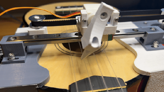

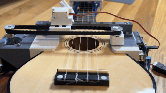

Step 6: Mounting the Rail
Now the linear rail can be put into place across the body of the ukulele. Once it's in the correct position, the rail mounts should be tightened all the way.
Next, take the 3D-printed servo mount and connect it to the timing belt. The servo mount has specific slots for securing the belt, so it should easily push into place.
Double check that the sliding block moves freely up and down the linear rail, and then screw the servo mount onto it, making sure that it's in the correct orientation.
Step 7: Belt and Pulley System
Place the idler pulley onto its mount, then loop the belt around it and the stepper shaft. Cut the belt to the appropriate length and insert it into the other slot on the stepper mount. This will allow the stepper to move the sliding block up and down.

Step 10: Stepper and Servo Code
Now it's time to get the mechanisms moving!
Reset the slider's position by moving it as close to the stepper as possible. Then upload the stepper.ino code, which uses the Accelstepper library, to test its movement (you may need to adjust the limits to ensure the slider has its full range of movement).
Once complete connect the micro servo to the Arduino and run the servo.ino code to verify its operation.
