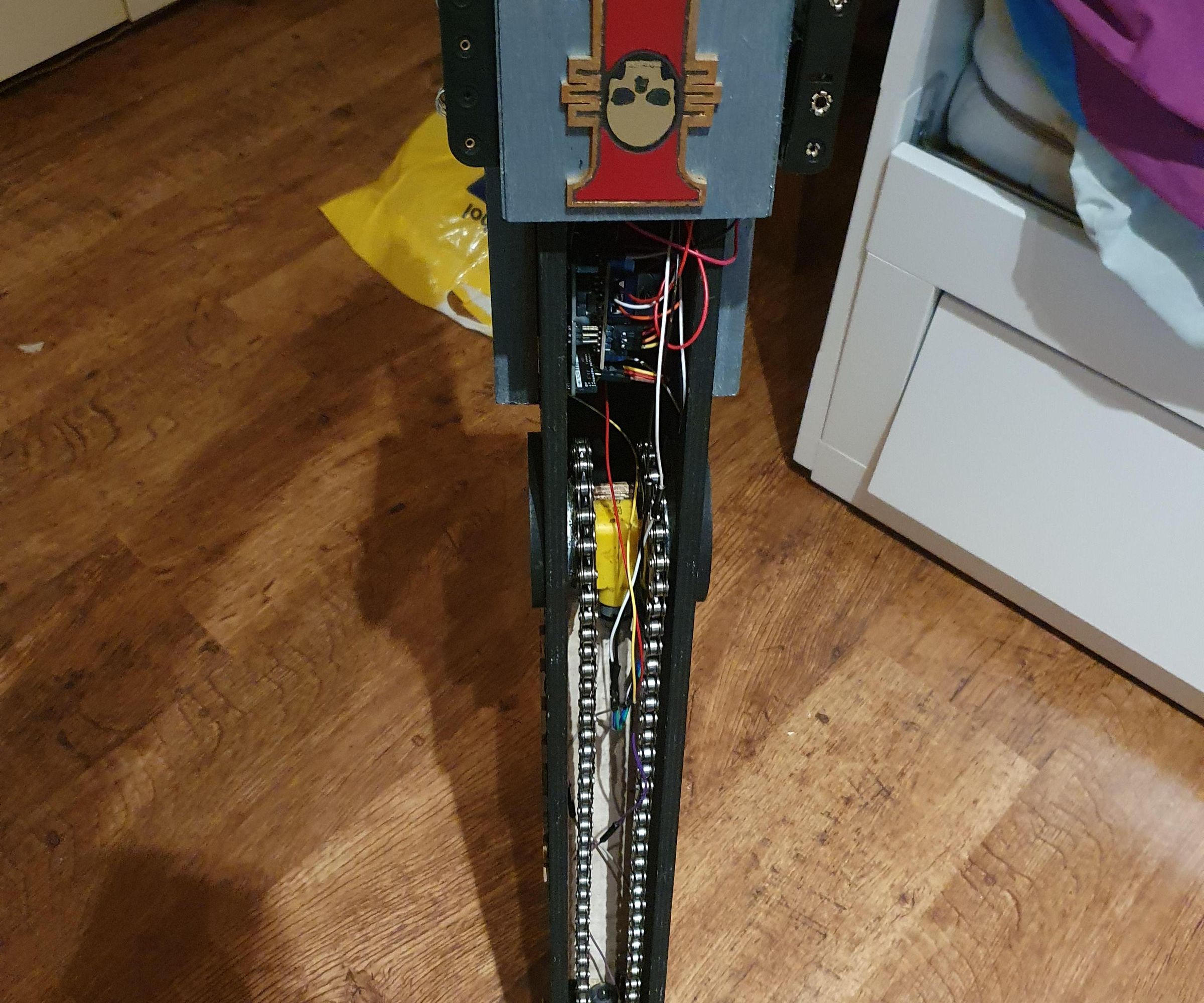

after putting all of the code onto the Arduino and plugging all the wires into the correct place you will need to put all of the components together to make it fit into the styrofoam ball.
place the Arduino on top of the wooden block and screw it into place, next place the motor driver on top of the Arduino, make sure it can not move from its spot on top.
next glue the servo motors with the wheels directly under the Arduino.
at last you can place your long power bank in between the servo motors to make a the third contact point of the machine when placed in the ball. to make it roll better it is highly recommended to wrap an isolation tube around the power bank, this helps it glide better on the styrofoam surface.
