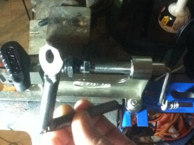

The idea is to automatically turn the crank handle on the threading machine clockwise
for a period of time and then turn it counterclockwise by controlling the screwdriver.
As the handle is turned clockwise, the die "grabs" the spoke and advances.
Rather than have the screwdriver advance along with the handle, a 90 degree crank bit
is built for the screwdriver. This crank bit gets a washer at the tip which accepts the
handle. The handle freely slides in and out through the washer.
Finally, a spring is loaded on the handle. Now when the spoke is inserted and
pushed against the die, the spring causes the die to slightly force itself onto the spoke,
allowing the die to "grab" and advance.

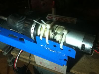

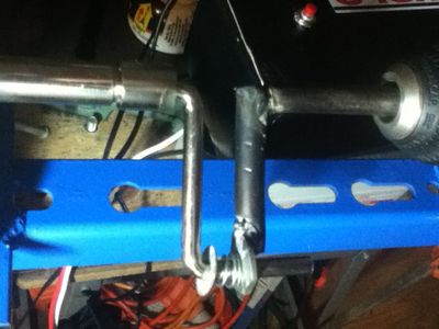

A bracket was welded up using angle iron. It bolts on securely to the spoke threading machine and supports the screwdriver's geared motor with electrical tie wraps.
The crank bit was welded with 3/8" rod and a washer. A compression spring was cut to size. The threading machine conveniently accepts a vise.
