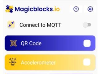

Step 2: Getting Started
On the app you have to make some changes first. Go to the settings page of the app and do the following changes. (For more information on the following see the info page on the app)
The above picture is an example on how to fill the fields,
1. Hostname field can be customized according to your broker. (See info page on the app)
2. Port field is best left default.
3. It is optional to provide a username and password and we recommend to do so if you are looking for secure transmission of data.
4. Publish topic and subscribe topic is up to you to decide. Any topic can be given.

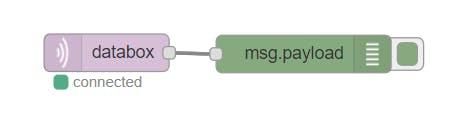

Step 3: On the Magicblocks Side
For simplicity first display data send from the phone in a debug node.
The above flow will be using.
In 'MQTT in node' the port, MQTT broker and the publish topic should be given. If you have chosen to fill the username and password fields on the app they should be entered in the node in the required field.
If everything goes well, after deployment under the MQTT in node you will see 'connected'.
Step 4: Start Sending Data
Now go to the app and connect the app to MQTT. If there is no problem connecting to MQTT you will see the 'connected ' notification. After that click on the sensors you want to send data to.
When all of this is done you will be able to see your data on the debug node output.
