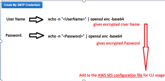

Next, create your SMTP Credentials
Step 2: Encrypt Your SMTP Credentials and Create a Configuration File
You will need to log into your server using a terminal access client such as Putty,
echo -n "<your_smtp_username>" | openssl enc -base64
displays YOUR_ENCRYPTED_USERNAME
echo -n "<your_smtp_password>" | openssl enc -base64
YOUR_ENCRYPTED_PASSWORD

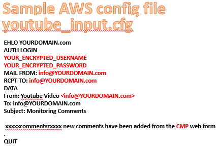

Next , create a file using nano ,
nano youtube_input.cfg
replace the fields as shown in the image with your details
youtube_input.cfg
EHLO YOURDOMAIN.com
AUTH LOGIN
MAIL FROM: info@YOURDOMAIN.com
RCPT TO: info@YOURDOMAIN.com
DATA
From: Youtube Video
To: info@YOURDOMAIN.com
Subject: Monitoring Comments
xxxxxcommentszxxxx new comments have been added from the CMP web form
QUIT

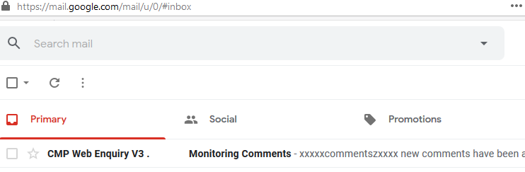

Step 3: Send a Test Email
On the CLI, type the following
emailcfg=$(cat ~/youtube_input.cfg)
This assigns the contents of your configuration file to the variable $emailcfg
then
openssl s_client -crlf -quiet -starttls smtp -connect email-smtp.eu-west-1.amazonaws.com:587 <<< $emailcfg 2>&1
You will need to change the AWS zone email-smtp.eu-west-1.amazonaws.com:587 to that which is in your SES SMTP settings
