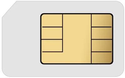

  • Sim card (You should disable the pin request on the sim card before using it with the GSM shield)

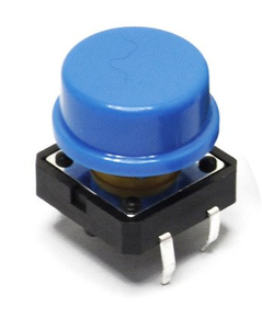

  • 2X button

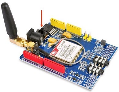

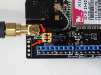

  • Connect with the Jumpers on the shield pins D8(RX) & D7(TX) like you see it on the picture
  • Make sure that the antenna is connected to the shield
  • Connect the 5V Power Supply to the shield, and set the switch on the shield to the External Power (See the picture)

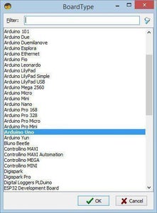

Step 3: Start Visuino, and Select the Arduino UNO Board Type

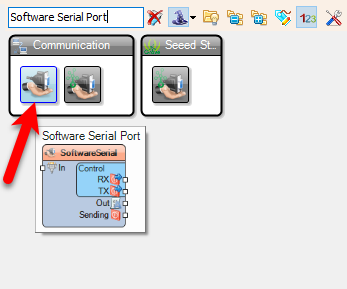

Start Visuino as shown in the first picture Click on the "Tools" button on the Arduino component (Picture 1) in Visuino When the dialog appears, select "Arduino UNO" as shown on Picture 2

  • Add "Software Serial Port" component

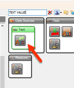

  • Add "Add "Text Value" component

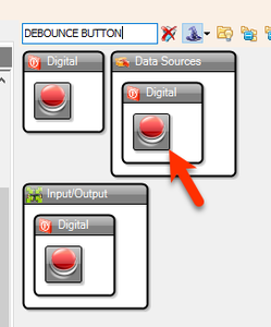

  • Add 2X "Debounce Button" component

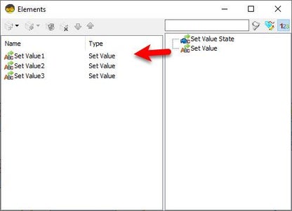

  • Double click on the "TextValue1" and in the Elements window
  • Command to set GSM shield to text mode: drag "Set Value" to the left side and in the properties window set "Value" to AT+CMGF=1

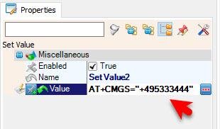

  • Command to set Phone number (International Format): drag another "Set Value" to the left side and in the properties window set "Value" to AT+CMGS="+495XXXXXX"

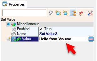

  • Command to set Text Message: In the Elements window Drag another "Set Value" to the left side and in the properties window set "Value" to Hello from Visuino

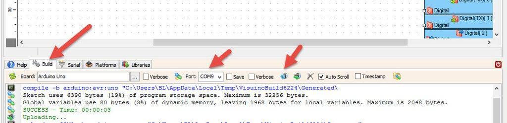

Step 7: Generate, Compile, and Upload the Arduino Code
In Visuino, at the bottom click on the "Build" Tab, make sure the correct port is selected, then click on the "Compile/Build and Upload" button.
