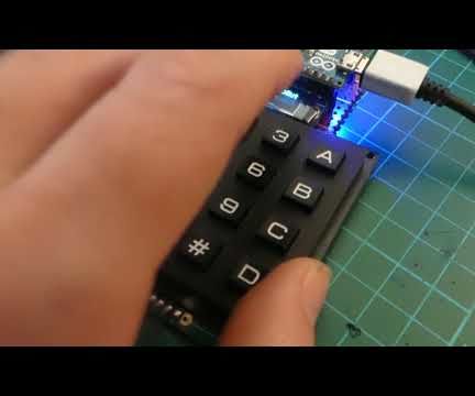

This could be used in many ways, for example:
- Make a badge reader using RFID to send a message when someone is at your fablab.
- Display the temperature of a room each hour.
