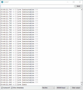

By receiving a laser light strike in the clock photodiode, the receiver will then trigger an interrupt that will read what is in data photodiode, the lack of laser light striking the photodiode will mean Zero and a laser light strike, One. [watch the Schmitt Trigger, it will invert!]
The receiver will println at the serial monitor every time a byte is received.
Observation: Serial Monitor must be opened before starting the transmission, also reopening the Serial Monitor while the data is begin transmitted, it will occur a reset, and it will probably start printing gibberish. [Arduino Limitation]

  5. Open Receiver Serial Monitor at 500000 bauds and at its right com port.
  6. Press the restart buttons at same time.
Now you are receiving messages using lasers!
