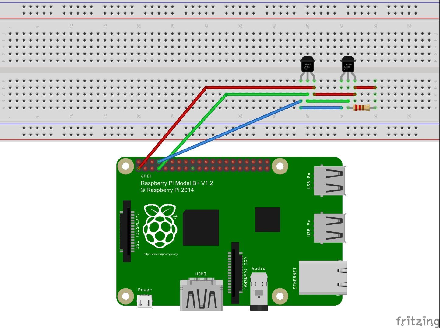

This project uses 2 DS18B20 1-wire temperature sensors. The sensors can be connected in parallel with only one 4.7K resistor.
The red wire is connected to the 3.3v pin, the blue wire is connected to ground, and the green wire is connected to pin#4 for data. The 4.7K resistor goes from data to 3.3V

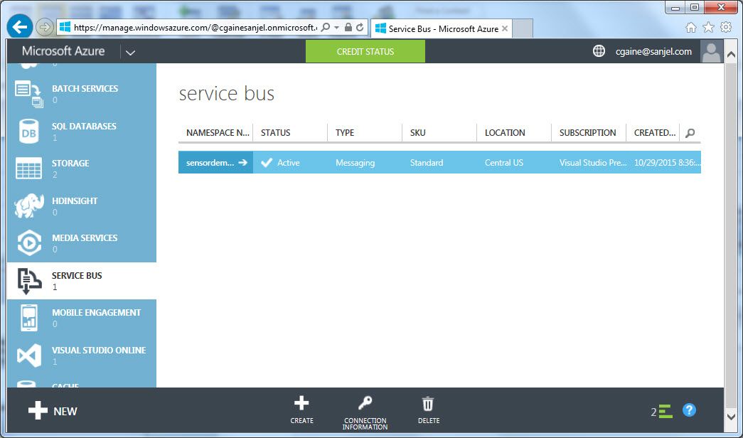

Step 3: Configure Azure Event Hub

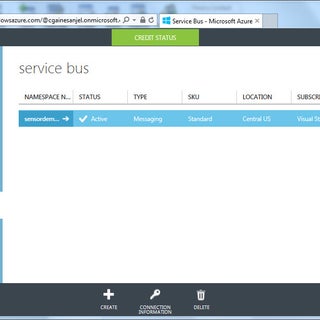

Log into your Azure management portal and create a Service Bus Name Space.
Click the Plus to create a new Service Bus name space. Give the Name Space a name then click the check mark to create.

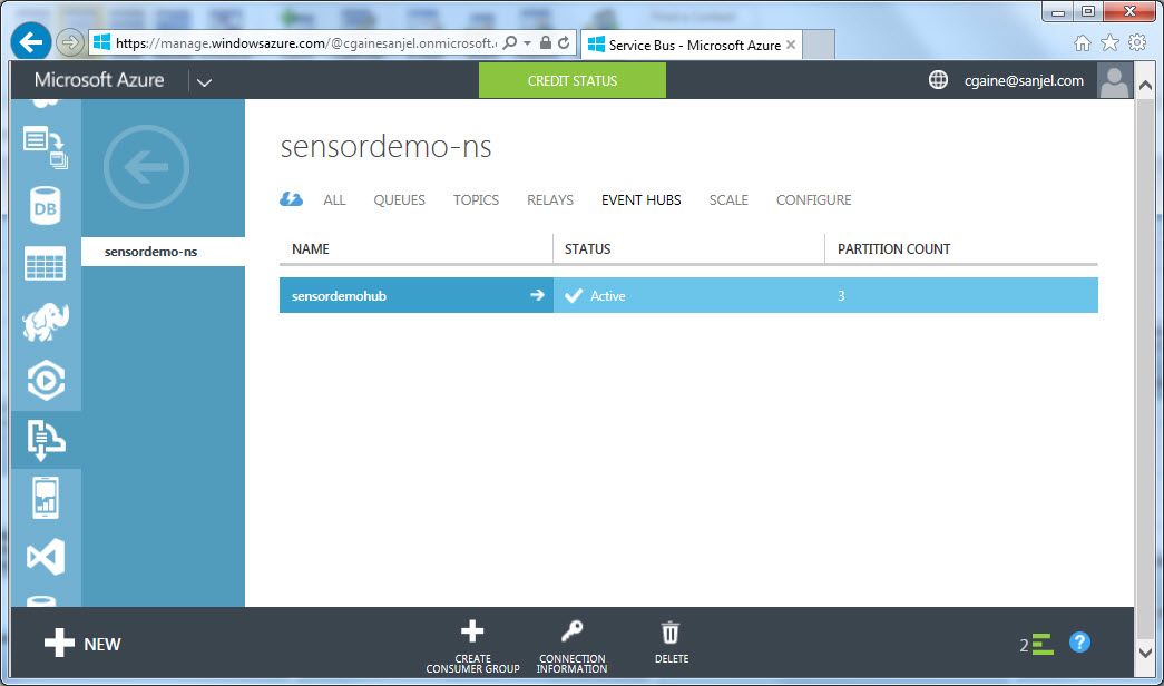

Within the Service Bus Name Space just created, create an Event Hub. Click the Plus, then Choose Quick Create and give the Event Hub and name then click Create.

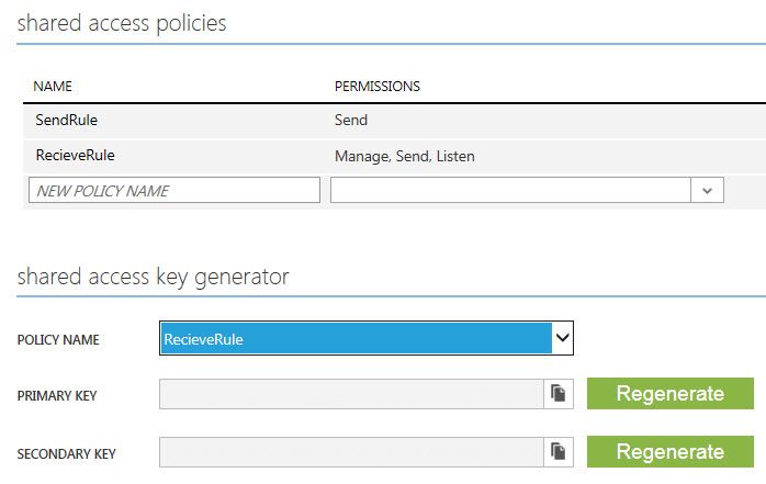

In the Event Hub page, click on the configuration tab. Create a policy called Receive Rule with permissions to Manage, Send and Listen. Then policy name and key will be needed later on.

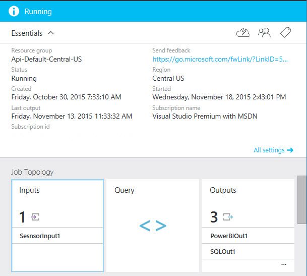

Step 5: Configure the Azure Stream Analytics Job
Click New to create a new Stream Analytics job, Give it a name and also specify the New Storage Account name, then click Create.
Open the Stream Analytics Job in the Azure Protal (https://portal.azure.com)
Then add and configure an Input. You'll need to specify the Service Bus Name Space, Event hub name. Also enter the policy and key we specified in the previous step. The Event serialization format should be JSON and Encoding should be UTF-8.
