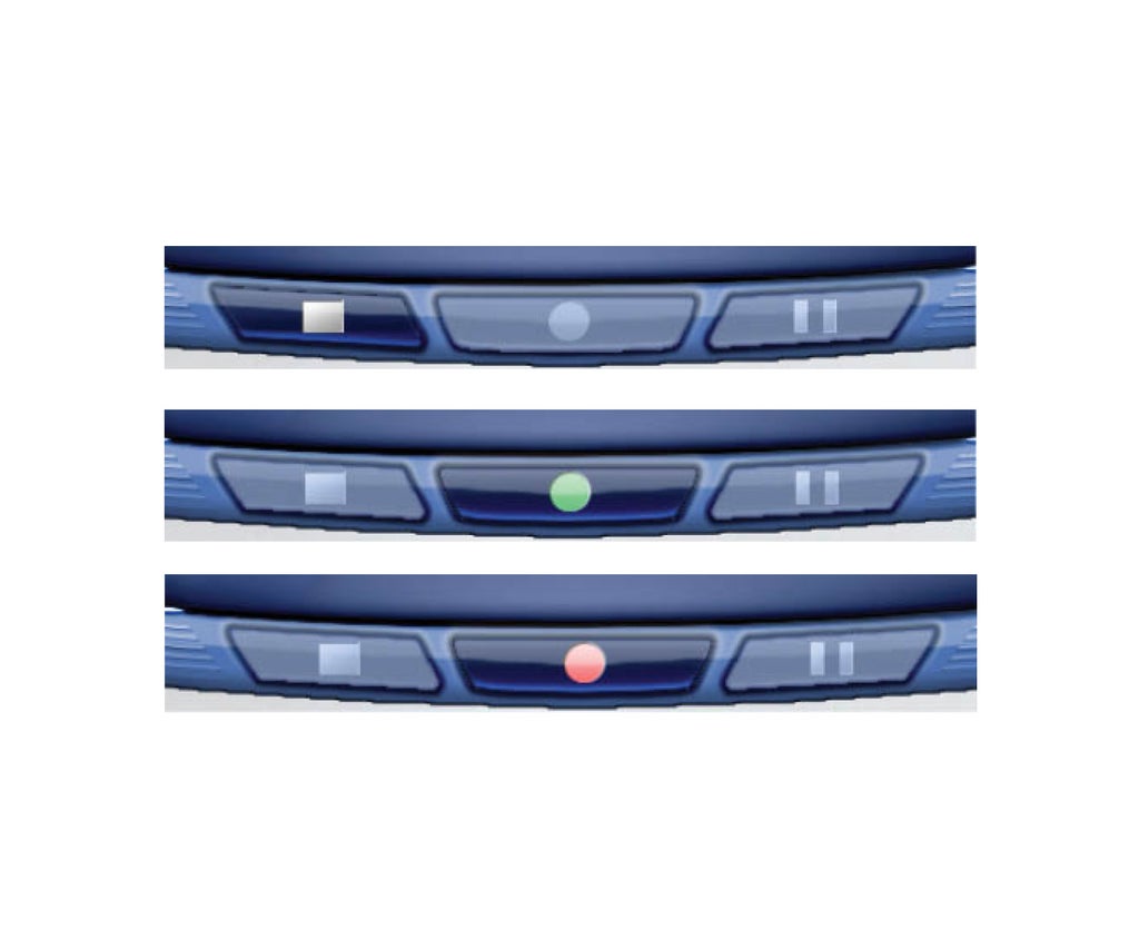

Check the status
There is a status light on the bottom center of the screen.
- Ghosted
- In use.
- Green
- Online; waiting for data from the Job Manager.
- Leave the printer in this mode after cleaning unless there is a job scheduled.
- Check the Job Manager for scheduled jobs every time you clean the machine.
- Red
- Offline.
- The printer will not function in this mode.
Change the status
If the button is red, click it once to change the status to green.
- Press the rotate button to see the temperature of the print heads.
- Once they are all green, the print will start.

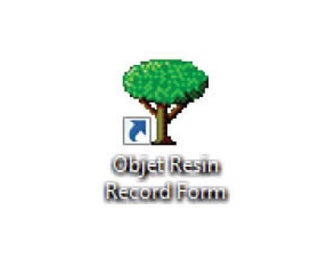

Record the resin usage
Users must log print jobs for the Objet, Fortus and Zprinter on their individual print tracker.
- If you do not have a print tracker, click the tree icon on the Design
Computer and fill out the request form.
- The form will be emailed to you.
- All resin use must be recorded and paid for.
- Model material = $0.41 per gram.
- Support material = $0.15 per gram.
- All project with 1,000 grams or more material (model and support combined) must have Shop Staff approval before printing.
