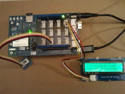

Introduction: Sending an Email From an Intel Edison (using Nodemailer)
This project demonstrates a method for sending email from an Intel Edison IOT computer by pushing a button connected to the Edison. While this may not seem particularly interesting or useful, one could imagine using this method as part of a more complex system. For example the Edison could be used as part of a monitoring system and it could send an email to alert whoever needed to be notified about the fault condition(s).

Step 6: Connect the I/O Components (pushbutton and LCD)
connect the pushbutton to the D2 connector on the Grove shield
connect the LCD to any I2C connector (it should not matter which one)
Step 7: Run the Program
In the code directory, run this command:
node main.js
If all previous steps were successful, then each time you push the button (attached to the D2 input pin) the Edison should send an email to the test address that you configured in the config.default.json file.
