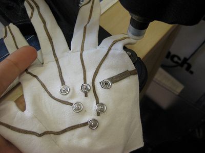

Step 5: Conductive Trace Again
On the back of the hand of the glove mark the position of the connection poppers. For this use the plug stencil that can be downloaded here:
>> http://kobakant.at/downloads/stencils/SensitiveFingertips-plug.pdf
You can also download the original size of the schematic illustration from here:
>> http://farm4.static.flickr.com/3401/3659523353_6ae26c39fb_o_d.jpg
Lay out the glove and continue to fuse the fabric traces from the fingers making your way towards the back of the hand to the appropriate marking. To know which finger trace should go to which marking, see the schematic illustration. One of the fabric traces from each sensor will all connect together and to the Ground (GND, -).
T = thumb
P = pointer
I = index finger
R = ring finger
L = little finger
T, P, I, R, L --> GND
Once you have fused all the traces into place, finish off by punching male poppers through the ends of the conductive fabric traces on the back of the hand, where the plug will attach.

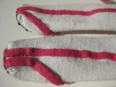

Step 6: Isolating
Cut strips from the jersey fabric with which you want to isolate your conductive traces. You don't have to use a fabric on top of the glue if you don't want to, but the glue tends to remain sticky and is hard to apply super evenly and so tends to look a bit messy. You can apply flour or baby powder to the glue once it has dried to get rid of some of the stickiness. Covering the glue with fabric strips is the easy way out. And it doesn't look bad.
Get out the stretchy fabric glue and apply it about 1mm thick and evenly to the conductive traces. Makes sense to do one side at a time. Wait for the glue to dry for about 10-15 minutes (when the bluish sheen is gone) before adding the fabric strips, otherwise the glue will seep right through the fabric.
Make sure you leave the beginnings of the conductive traces on the fingertips exposed! Otherwise you can't make the sensor.

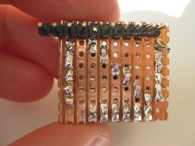

Step 8: Pullup and Low-pass Filter Circuit
Cut a piece of perfboard 8 x 9 holes big. Copper lines running the shorter distance. Solder one 4.7uF capacitor (low-pass filter) and one 50K ohm resistor (pull-up resistor) between each input and the +.
Please take a close look at the photos and illustrated diagram to see how things are connected.

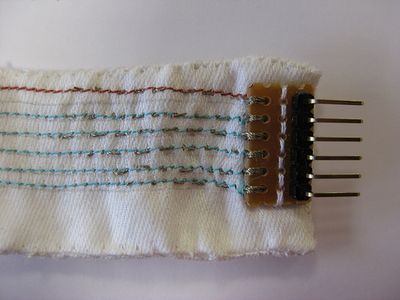

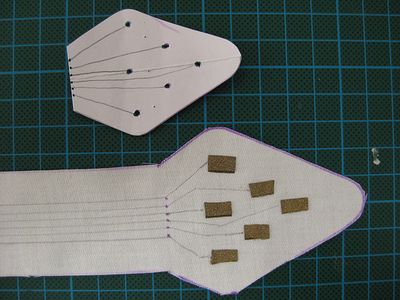

Step 9: Plug and Cable
Trace the cable stencil twice onto the piece of non-stretch fabric. Cut out small squares of stretch conductive fabric and fuse them to the positions of the Xs marked on the cable stencil.
Prepare your sewing machine with conductive thread. Wind the 117/17 2ply conductive thread onto a bobbin. For the top thread of the sewing machine you can use any colour you like. Preferably make the GND cable stand out by choosing a different colour than the rest.
Sew from the patches of conductive fabric all along the meter of non-stretch fabric to the other end (see photos and stencil), leaving about 10-15 cm extra of the conductive thread that later need to be sewn to the perfboard.
Make sure that the threads do not fray or make any sort of contact between one another. Their spacing should be about 2mm so that they line up with the spacing of the holes on the perfboard.
When all the threads have been sewn, pierce female poppers through the patches of conductive fabric. So that the face of the popper is NOT on the side of the conductive thread.
If the fabric you used is rather thin, you can reinforce it in the head part with an extra layer and some fusible interfacing. This will stop the poppers from tearing the fabric when you connect and remove the plug.
You can also add some fusible interfacing on top of the conductive side of the threads, so that when you have sewn and turned the cable inside out you can fuse this fusible by ironing over it and it will stop the threads from making bad contacts within the cable.
Lay right sides together (conductive stitches facing outwards) and sew the pieces for the plug and cable together, leaving the end with the loose conductive threads open. Turn the cable inside out. And close by hand.
Stitch the loose conductive threads to the perfboard. Make sure none of them touch each other. You can use some of the fabric glue to isolate them when all of them have been sewn.
