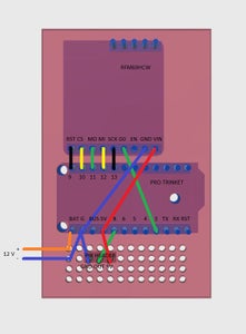

The case features a integral 3D printed circuit board. Note the wiring diagram is shown from the back side of the device.

The circuit board wiring diagram shown is from the back of the board.
