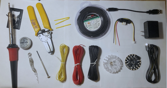

Materials:
Wire stripper/cutter
Flathead screwdriver
Hairdryer or heat gun
Computer
Soldering supplies
26 AWG black, red, yellow wire
Heat shrink tubing https://www.amazon.com/gp/product/B0B616ZH42/ref=ppx_yo_dt_b_asin_image_o04_s00?ie=UTF8&th=1
Heat shrink tubing assorted sizes
3’ USB A/micro B data cable ( NOT charging only)
https://www.adafruit.com/product/1197
6” USB A/micro B cable (charging only) https://www.amazon.com/gp/product/B003YKX6WM/ref=ppx_yo_dt_b_asin_title_o05_s01?ie=UTF8&psc=1
Cube plug
IOT Relay Power strip
IR sensorhttps://www.amazon.com/gp/product/B075FPR2VX/ref=ppx_yo_dt_b_search_asin_title?ie=UTF8&th=1
CPX microcontroller
https://www.adafruit.com/product/3333
CPX cover
https://www.amazon.com/Adafruit-Circuit-Playground-Express-Enclosure/dp/B07R53GYW1

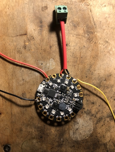

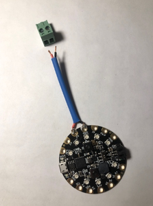

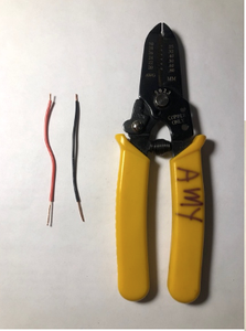

Cut 3” pieces of both red and black wire. Using wire stripper, remove ¼” of the plastic from each end of both wires.
Solder the red wire to Pin A2 on the CPX board.
Solder the black wire to the Ground Pin located between Pins A1 and A2.
Cut a 2” piece of heat shrink tubing ans slide it over roth red and black wires.

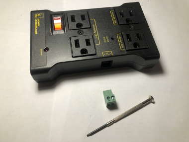

Remove screw terminal from the Power Strip Relay. Use small flathead screwdriver to release the screw terminals.
Install red wire in the left terminal (+) and the black wire in the right terminal (-). Shrink the tubing with hairdryer.

Cut three pieces of wire 30” long of the following colors: red, black and yellow. (You can choose any length - I like 30" because I can position the sensor near the viewer and hide the rest of the electronics from view)
Solder the yellow wire to Pin A1, black wire to Ground and the red wire to the 3.3V Pin.
Twist the wires together and slide the heat shrink tubing over them. (Do not shrink the tubing yet!)
Trim the wires on the sensor and solder them to the matching color wire.
Heat shrink each individually, then slide the larger piece of heat shrink tubing over the solder joint and shrink the entire tube with a heat gun or hairdryer.

Push the green screw terminal back into the Power Strip. Connect the 6” USB A/micro B cable to a power cube, and plug into the “Always ON’ plug on the power strip.
Attach the protective cover onto the microcontroller.
Plug a light (turned on) or other testing device into the power strip in one of the two “Normally OFF” plugs.
Plug in the power strip and turn on the power.
Wave your hand about a foot in front of the sensor. The light should go on, and then turn off after 3 min.
