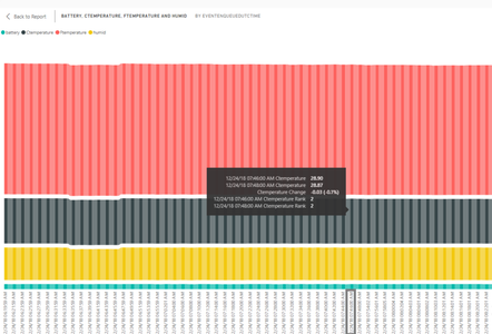

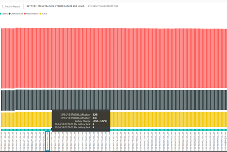

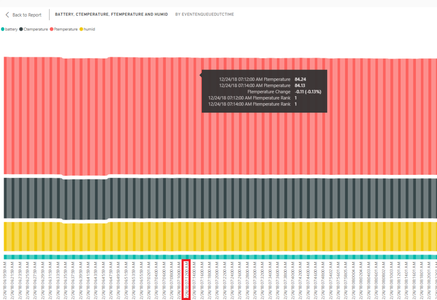

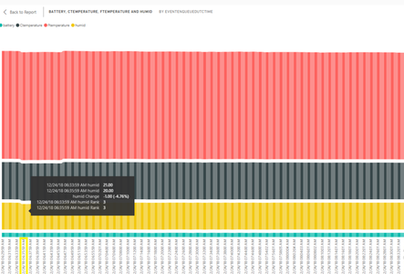

Step 3: Analyzing Data in PowerBi
We are using Power BI to visualize the data. It provides interactive ways to analyze data. This data can be interpreted in the form of Line charts, Bar graphs, Pie charts etc. Start by creating an account in Power Bi and sign in into your account. In the last post, we had set up Power Bi and sent data to Power Bi using stream analytics job. In this post, we are using Azure function to send the sensor data to power Bi. To set up Power Bi read this blog.
There are four methods to send the data to Power Bi:
  • Directly streaming the data to Power Bi from IoT hub.
  • Using API to send data to Power Bi.
  • Using web-hook functionsUsing PubNub.
Here in our case we are using Power BI API and sending a HTTP response to Power BI from azure function. There are different graphs, line charts, Pi charts etc. listed in the Visualization panel. We can create the chart by selecting any of the graphs from the Visualization panel.
We can also export the data as an excel sheet or in CSV format. Which in later stages can be used for data analytics.

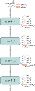

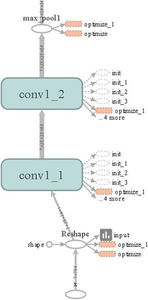

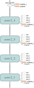

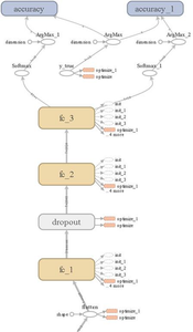

We are using LDA(Linear Discriminant Analysis) which follows Linear Regression to Train the data. Once the feature are extracted using LDA. The features are provided to the Convolution layer. At this layers the weights are convoluted with the input and the biases are added to it. This process go on for different convolution layers. Then we add a max pooling layer and add a activation function(We are using Relu in our case more on this can be found in this research work) where the features are down sampled again to map the data with correct labels. Then at the end we have a fully connected layer where the features are again down sampled to the label size. The size of last layer is equal to the size of labels.
Step 6: Getting the True Values Using Test Set
The trained values are then passed through the softmax layer. The softmax layer is used to optimize the training set. Find accuracy and minimize the loss using gradient descent. The training model is then compared to the test data to predict the true result. Our model is based on VGG net. More on this can be seen here.

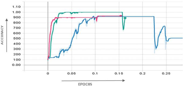

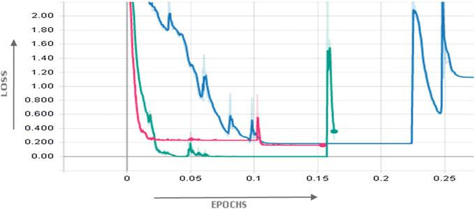

Step 7: Optimizing Accuracy and Loss
We optimized the data set for 2000 iteration and found the following results:
Training Results
  • Training accuracy (1500 epochs)- 100%
  • Training Loss(10 epochs)- 3.4%
Test Results
  • Test accuracy (1500 epochs)- 98.7%
  • Test Loss (10 epochs)- 12.5%
