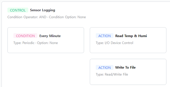

Step 3: Control 1 - Periodic Data Collection
Create a logic and control that reads sensor data every minute
  1. Condition (Periodic): Every 1 minute (60 seconds)
  2. This triggers our data collection every 60 seconds
  3. Action 1 (I/O Device Control): Read BME280 sensor
  4. Device: BME280 Temperature & Humidity Sensor
  5. I2C Address: 0x76 or 0x77 (check your module's datasheet)
  6. Command: Read Data
  7. Store temperature in variable: Temperature
  8. Store humidity in variable: Humidity
  9. Action 2 (Read/Write File): Append data to CSV file
  10. Create new file editor
  11. Command: Append (adds new data without overwriting)
  12. File Path: Use block editor to create dynamic path
  13. Write Content: Use block editor to format CSV line
