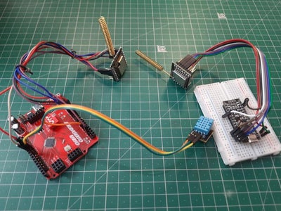

Step 3: Circuit Diagram:
Because my Lora module RA01 works on SPI interface so an external library is used for the communication. Here MOSI, MISO and SCK pins are connected to D11, 12 and 13 respectively. For reset we are using D9 and D10 NSS(Enable). No need to define these pins in code because these are default with the Lora library. D0 of the Lora is connected to D2 of the Arduino. LoRa works on 3.3volts, 5v can damage the entire setup.
DHT11 sensor is connected to the transmitter which reads the data. Any blank digital pin can be assigned for DHT. Then Arduino process that and make a string of that data to send to the receiver. the connections for the lora are same on both receiver and transmitter end. I am using Arduino nano for the receiver and UNO for the transmitter only for demonstration purpose.
The receiver connections are also same and instead of any external screen we are using Arduino IDE serial monitor to display the values. We can use one receiver for many devices just change the to change the address, but this is the topic for another article.

Step 9: Project Working:
In this way you can read any data from sensor, the data is just a value that can be send over air to long distances using string functions in LoRa. Now sometimes the received data is just mistitled because of voltage fluctuations and noise. But you can add an external capacitor between power lines and reset the microcontroller which can solve this problem.
