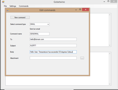

Step 2: Command Config
In the previous step, we setup the mail server and account that GoBetwino will use to send mails.
Now we will setup the command it will respond to.
- Go to the 'Commands' section in GoBetwino.
- Click on 'New Command'
- Select command type 'SMAIL'
- Here, 'Command Name' is a very significant field because this is what the LinkIt One should send via Serial.
Enter a command name like 'SENDMAIL' (all caps, without quotes). - Enter the email ID you want to notify in the 'To' field.
- Enter the subject, body and attachment (if any).
- Click on Save and then Exit.
Now GoBetwino will send this email whenever it receives the command SENDMAIL through Serial Port.
