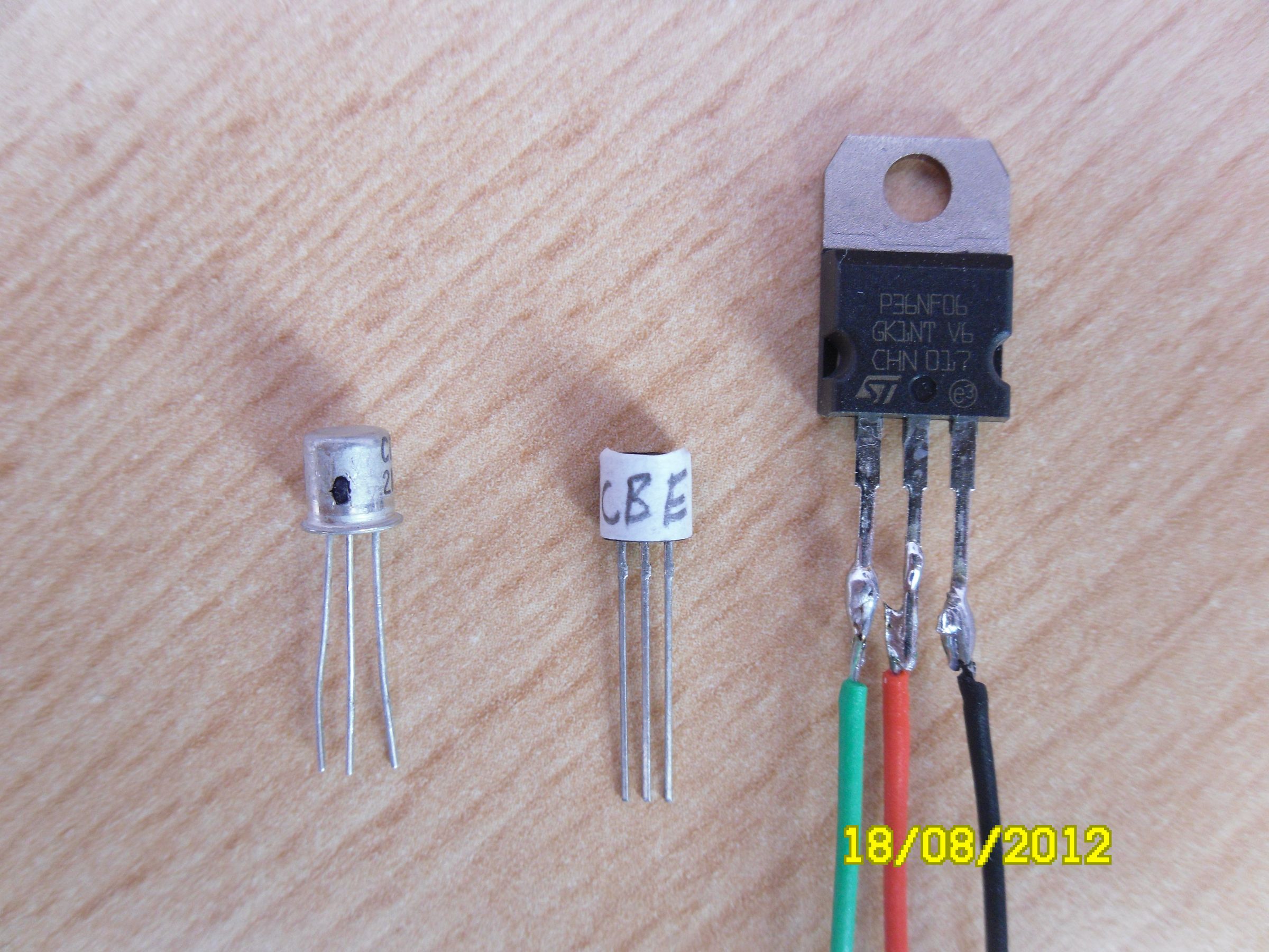

Double check the datasheet for your MOSFET and make sure that you connect the pins in the correct places otherwise the MOSFET will get really hot and probably break. The MOSFET I will be using is an "STP36NF06 Power switching MOSFET".

You can experiment with the input and output devices, for example a phototransistor which is used to detect infra-red beams, this could be used as the input device and a motor as the output device, point a TV remote at the phototransistor press some buttons and the motor is activated.
