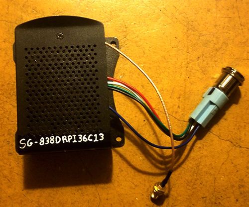

Here I explain how to connect to your Raspberry Pi SensorGnome and download Data
A Raspberry Pi has 4 USB ports and an Ethernet port on one end. Most will also have a pushbutton attached.
See Sensorgnome.org for more information.

Step 1: Power on Your SensorGnome
Plug in the SensorGnome to power it on. You can tell it is on when a red LED begins flashing from the top of the case.
Wait for 1-2 minutes to allow the SensorGnome to load its software.
