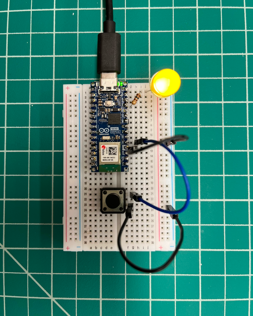

Step 2: Test Components Using Breadboard
  1. Insert your Arduino Nano ESP32 across the center channel of your breadboard (it should straddle the gap)
  2. Connect the NO switch: one terminal to pin D9, the other terminal to GND
  3. Build the LED circuit: D2 → 100Ω resistor → LED long leg (anode, (+)), LED short leg (cathode (+)) → GND
  4. Double-check all connections against the circuit diagram
Note: The pins in the above image are switched; so refer to the Tinkercard for reference!
Sensory Bookmark Circuit
Step 3: Upload and Test Code
  1. Copy the Arduino Code into Arduino IDE
  2. Read through the code comments for context
  3. Click the Upload button (right arrow icon) in Arduino IDE
  4. Wait for "Done uploading" message
  5. LED should turn on when tactile button is in the default state, and turn off when the button is pushed
