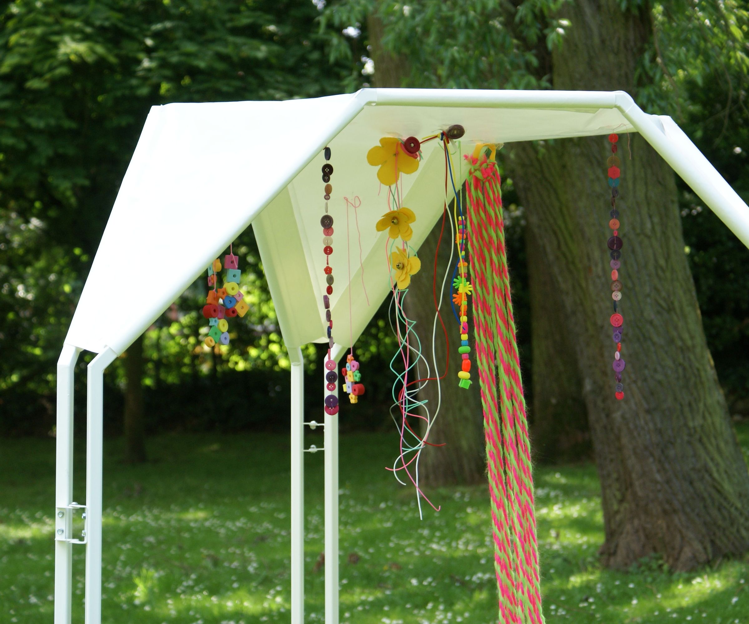

Step 2: Make the Connections
With these button fastenings, it is possible to attach the garlands to the ceiling of the snoezeltent. There is a pattern of buttonholes in the ceiling of the tent.
We chose buttons because they are cheap and easy to attach and loosen. Depending on the place where you want to mount the garlands, you can opt for a different fastening system such as strong velcro, magnets, ...
  1. cut a piece of +/- 10 cm elastic band
  2. put one end of the elastic band through one of the holes of the first button
  3. make a loop and put the elastic band through another hole of the first button
  4. put the ends of the elastic band through the other button
  5. make a knot and cut the ends
The second button serves mainly as a decoration. So when you watch the ceiling of the snoezel tent, the buttonholes are nicely covered.
To each of these button connections you can one or multiple garlands.
Step 3: Make the Foam Pearls Garland
Glue the foam pearls toghether with superglue in a random pattern.
Make a knot with a colourful cord to one of the pearls and tie the other end to the button connection.
You can attach multiple of these patterns to one connection.
Step 4: Make the Button Garland
Cut a string of sewing thread twice the length you want the garland to be. Tie the ends of the sewing thread to a button. Put a second button on the thread. Make a loop and put the thread in another hole of the same button. Repeat this steps until the garland has the length you want.
Next, attach the garland with a knot to one of the button connections
Step 5: Make the Flower and Bells Garland
First, cut fabric flowers in three different sizes. Make three flowers for each size, that's the amount you'll need to make one garland. Then, make a little perforation in the middle of each flower. Make three piles of flowers, with in each pile a small, medium and large flower.
Next, put the ring of the bell through the perforation. Repeat this step for each pile of flowers.
Attach the piles of flowers to the scoubidou rope by making a knot to the rings of the bells.
Attach these ropes to the button connections and add some extra scoubidou ropes for a more aesthetic effect.
