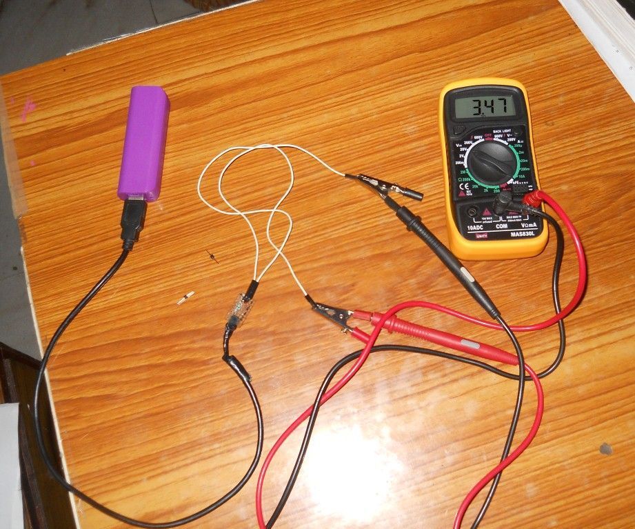

Step 2: SOLDERING COMPONENTS
First of all solder the resistor and zener diodes then transistor, then ic socket and at the last sold the db-9 port.
Step 3: Use the Programmer.
I used my USB-2-TTL board to power my avr icsp board, u can use external battery or any other power source as per your requirements.
