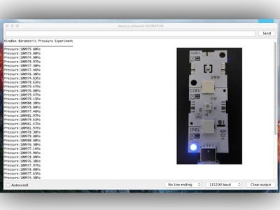

  • Open the serial monitor in the top, right-hand corner of the screen. It should look like the image below after a few moments.
Figure 4: Serial Monitor displaying Pressure readings
  • You can now view altitude readings from the SW01 on the serial monitor.
