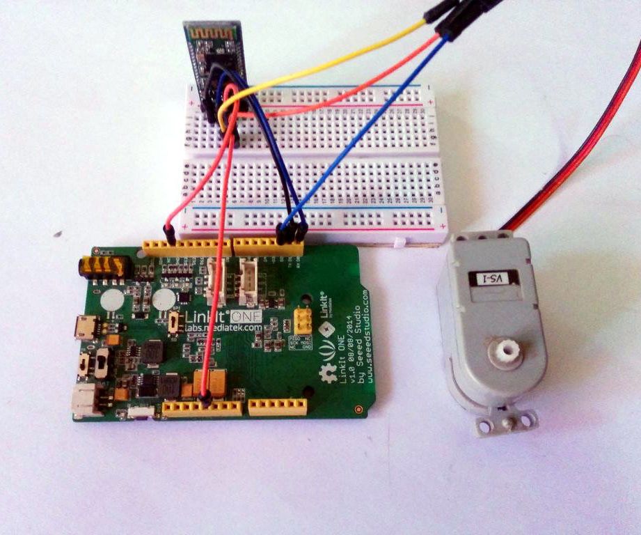

Step 2: Schematics
All the connections you need to do is connect the TX pin of the arduino to the RX pin of the Linkit One, Connect the Rx pin of the arduino to the TX pin of the Linkit One. And also connect both the GND terminals together.

Step 4: Setting It Up
Open up a serial monitor and you can transmit data across the two boards.
