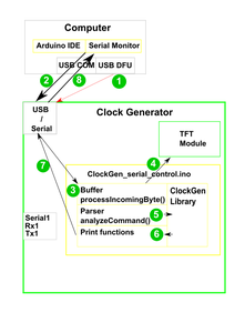

Step 1: Principle of Working - You Control the Clock Generator From the Serial Monitor
The Clock Generator is a standalone board that provides 3 programmable clocks. Being Arduino compatible you can change the default program. In our example we will upload a new program that allows to communicate with the clock generator using the Serial port to modify the Clock Generator settings. Any board or even the Arduino Serial Monitor can send data as long as the commands are properly formatted. In this example we will use the Arduino IDE's Serial Monitor to send commands and get back the updated state of the device:
1) Loading the Arduino sketch named ClockGen_serial_control.ino to the Clock Generator board using the USB port in DFU mode (you might need to reset the board so the computer can detect the DFU device).
2) A COM port is then enumerated. After launching the Serial Monitor you can type a command. It is sent to the Clock Generator USB/Serial port.
3) The ClockGen_serial_control.ino has a function named processIncomingBytes() that buffers the bytes received until it receives the end of line (\n).
4) It logs each byte received on the TFT screen.
5) When a complete and meaningful package is received the proper function of the ClockGen library is called to modify the configuration of the device.
6) The updated configuration is queried from the ClockGen library.
7) This info is transferred to the USB/Serial interface.
8) It is carried through the USB COM port to the Serial Monitor.
Step 2: Principle of Working - the Controlling Board Controls the Clock Generator

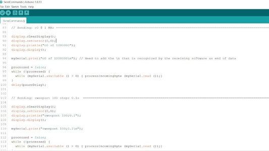

Now we will use the Narrow board to control the Clock Generator:
1) Loading the Arduino sketch named ClockGen_serial_control.ino to the Clock Generator board using the USB port in DFU mode.
2) Loading the Arduino sketch named SendCommands.ino to the Narrow board using the USB COM port (of course this means that you will have to change the board settings in the Arduino IDE). The Narrow board is a good solution here because it has 2 serial ports and can have an OLED attached on top of it.
3) After loading the sketches, we might not need the computer anymore. The SendCommands.ino sketch will send a command to the Clock Generator through one of its Serial ports. If you have only one port available you can use it if you disconnect the USB cable to make sure the USB will not interfere.
4) It will log the command on the OLED.
5) The Serial interface sends data from its Tx pin to the Rx pin of the Clock Generator.
6) The ClockGen_serial_control.ino has a function named processIncomingBytes() that buffers the bytes received until it receives the end of line (\n).
7) Each byte received is logged on the TFT screen to make it more visual for the user.
8) A parser analyzes the command. If it has a meaningful command and the expected parameters, it will call the appropriate ClockGen function to modify the configuration of the device.
9) The current state of the device is read from the device and this info is sent to the Serial interface.
10) The data is sent from the Tx pin of the Clock Gen to the Rx pin of the Controlling board.
11) The processIncomingBytes() function of the SendCommands.ino buffers de received data.
12) When a complete packet is received, this raw data is sent to the OLED for logging. So, the user knows precisely if the Clock Generator was properly programmed. He can read the current state of the device that was transmitted back without any modification.
The arrows printed with dotted lines show an alternate path.

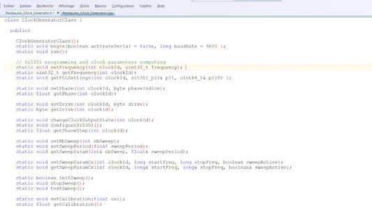

Step 4: Explanations on the Clock Generator Library
The Pandauino_Clock_Generator.h library defines a class and an instance of this class named « ClockGenerator ».
A couple of functions can be called from within any C++ program and particularly from an Arduino sketch. For example:
void begin(); initializes the program: Set up the Si5351A chip, retrieves values from EEPROM etc...
void run(); to be called in the Sketch loop to check the interaction with buttons etc
void setFrequency(int clockId, uint32_t frequency); to set the frequency in Hz of one of the clocks (id= 0,1 or 2)
uint32_t getFrequency(int clockId); to get the frequency in Hertz...
See the Clock the Clock Generator user’s manual for a full explanation.
Step 5: The Programming Environment and Software Prerequisites
  • To program the Clock Generator, which is an STM32 based board, you will need to add the board definitions and set the board parameters in the Arduino IDE correctly. See the Clock Generator user’s manual.
  • To program the Narrow board, which is an Atmega644 or Atmega1284 based board, you will also need to add the boards definition and set the board parameters in the Arduino IDE correctly. See the Narrow user's manual.
  • You can use another Arduino board or Arduino compatible board as the controlling board as long as it has enough flash (> 13 KB) and RAM (> 2 KB).
To control the board from the Serial Monitor you will need all the libraries referenced in the Clock Generator library so you will be able to compile the ClockGen_serial_control.ino sketch:
To control the board from the controlling board you will need the OLED library, that is a modified Adafruit library to support 64x32 OLEDs: https://github.com/mrguen/Adafruit_SSD1306-master-...
Finally you will find the ClockGen_serial_control.ino sketch in
https://github.com/mrguen/ClockGen/tree/main/examp...
And the sendCommands.ino sketch in

Step 7: Simple Use of the « ClockGen_serial_control.ino » Sketch
You can upload the « ClockGen_serial_control.ino » sketch to the Clock Generator, then open the Serial Monitor and type commands.
For example, if you type « c0 sf 1000000 » and the enter key, then you will set the clock 0 frequency to 1 MHz and the Serial monitor will then print this frequency so you are certain the command was executed properly.
The possible commands are printed in the Serial Monitor when you launch it and if you type something that is not recognized as a command.
You will need to modify a little the sketch in order for it to answer to the Serial Monitor. It must use the Serial (i.e. USBSerial) com instead of Serial1 (that will be used to communicate with a standalone controlling board)
At the beginning of the sketch modify the #define mySerial like that:
//#define mySerial Serial1    // Use Serial1 to communicate with a standalone device through the Rx and Tx pins
#define mySerial Serial       // Use Serial (=SerialUSB) to communicate with the Serial Monitor through the USB connector
Step 8: The « SendCommands.ino » Sketch
This sketch will be uploaded to the controlling board. It will
  • Send commands to the Clock Generator
  • Log the command sent and the resulting state on a 0.49 » OLED mounted on top if it
It is composed of :
  • in the setup() function it sends a couple of commands. For each function it:
    • first, log the command on the OLED
    • then sends the command to the Clock Generator
    • and waits for the Clock Generator to receive a complete line:
  display.clearDisplay();
  display.setCursor(0,0);
  display.println("c0 sf 1000000");
  display.display();
  mySerial.print("c0 sf 1000000\n"); // Need to add the \n that is recognized by the receiving software as end of data
  processed = false;
  while (!processed) {
    while (mySerial.available () > 0) { processIncomingByte (mySerial.read ());}
  delay(pauseDelay);<br>
