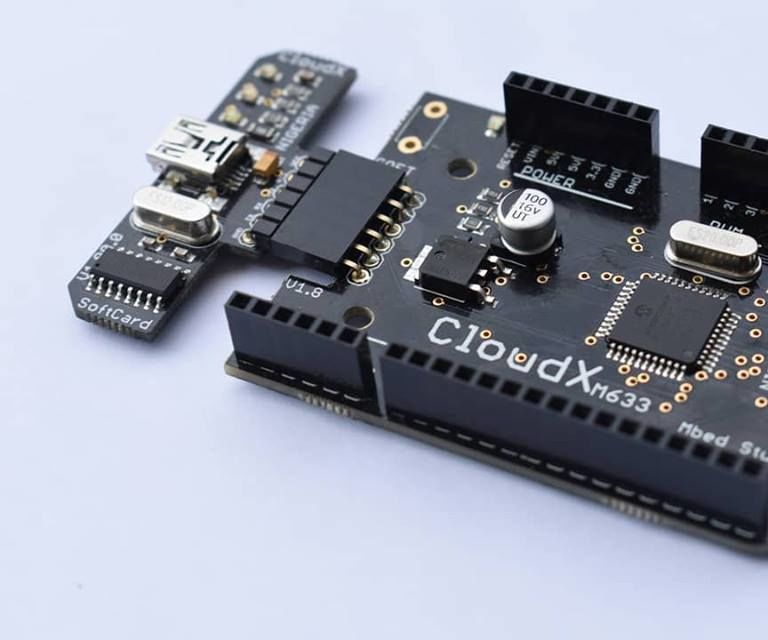

2. Hardware Debugging:
In this method, every test and debugging is done by attaching the CloudX prototype board to the PC using the softCard and making use of either CloudX IDE's serial terminal (recommended) or some other useful software like Proteus ISIS compim, realTerm, etc. Generate COFF file cant be used here because this method demands HEX bootloaded into the hardware, I recommend using this for CloudX softcard. Note that your code run without stepping so you can always know where which line is the controller is running at any given time by the serial output. lets take a look at this code the same example listed above, setup your hardware to be similer to mine red LED --------- to pin1 green LED --------- pin2 yellow LED --------- pin3 button --------- pin4
Step 3:
steps
1. Use same code as above
2. bootload into your board
3. start the CloudX serial Terminal by clicking "serial" button in the tool bar
4. select desired port and baud rate(9600 in this tutorial)
5.start the terminal by clicking on connect(disconnect if you desire to quit)
6. with the port opened/connected,momentarily push the button at will and you will see the serial output shown on the terminal windows. Note that if you have the delays off the code, you will get multiple lines of serial output running in so fast without control before you take your hands off the button. If for any reason in your code, you have such or similar problem, you can always use this method to debug.
