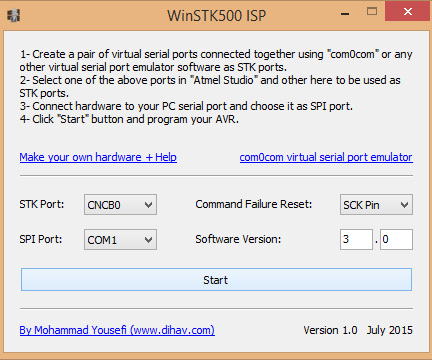

On your PC connect to “dihavSerialPort_XXXXXX” access point, device IP address in access point mode is “192.168.4.1”.
Download the Windows application I uploaded here, and execute it on your PC. Type device IP, choose baud rate, stop bit, data bits, parity and click "Connect" button. Click “Allow access” button on “Windows Security Alert” window. You can send data by typing it into the box below "Disconnect" button as ASCII, hex or decimal and press related "Send XXX" button. Sent and received data will display in six boxes below "Send XXX" buttons.
There is an HTML-based interface that makes it possible to access serial port in a web browser on any OS. To access it type “192.168.4.1” in the address bar of your internet browser and hit enter.
Step 7: Serial Data Forwarding
In many applications, there is a software that must connect to a device via serial port. To make this possible download com0com and install it on your PC. Create a pair of virtual ports choose one of them as the serial port in "dihav SerialPort over WiFi” software and select other in the software that controls your device. To establish connection press connect button.
