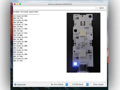

  • Open the serial monitor in the top, right-hand corner of the screen. It should look like the image below after a few moments.
  • You can now view altitude readings from the SW01 on the serial monitor
