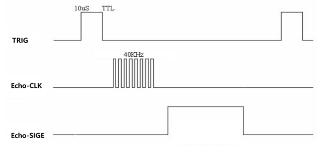

Step 2: Principle of Ultrasonic Ranging Sensor
Principle of ultrasonic ranging sensor
Working principle of the module:
(1) Use IO port TRIG trigger ranging, to at least 10US high power flat message.
(2) The module automatically sends 8 40khz square waves and automatically detects whether a signal is returned;
(3) When a signal returns, ECHO outputs a high level through the IO port, and the duration of high level is ultrasound The time from emission to return of the wave.
Test distance =(high level time * sound speed (340M/S))/2

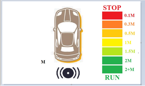

Since the display resolution is 800 by 480, you need to create a background image first. Use the computer's own "drawing tool" to edit, set the canvas size to 800*480. Place the material you want to render in the background image. After editing, name the file number, for example, 0.jpg. (as shown in the 1st picture)

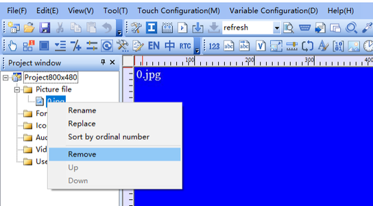

Open display manufacturer to provide the interface editor software "TOOL 2019. Exe", click "New" project in New projects, after creating the project engineering, first delete the project's own background images, click the "Add" New good background picture, click the button "Text variable" continue to Add Text control, the control in the proper position of the background image, used to display the ultrasonic measurements. (as shown in the 2nd、3rd and 4th picture)

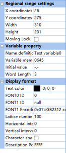

You need to set the parameters of the text control when you finish adding.
Memory address: 0645. Only one text control is used this time. The memory address of the control remains unchanged by default. Initial value: -.-, the sensor has not started working when the display screen is just turned on, so the initial value of the text display is set to the content "-.-" in the case of no obstacle detected. Byte length: 3. Since only one decimal point is displayed, the text content shows only three words, so the byte length is set to 3. (as shown in the 5th picture)
Compile the project after adding and setting.
Note: The start screen needs to be set in the Settings interface. The number to be set should be the same as the filename of the background image. Otherwise, a warning will appear after compilation and the display screen will not display properly. This is where I often make mistakes when I am new to this screen. I would like to point out that, please pay attention! Download the display screen project, insert the USB flash drive into the computer, and click to download to the USB flash drive. After downloading, the display screen will be powered on and the U disk will be inserted into the download interface on the display screen to complete the download.

(1) According to the timing diagram of the ultrasonic sensor, the STM32 MCU needs to provide a trigger signal to the ultrasonic module, and the ultrasonic module will transmit the measurement results to the STM32 MCU IO pin through IO pulse. (as shown in the 1st picture)
Write the corresponding ultrasonic data reading function according to the time sequence diagram
Ultrasonic data reading function ****/

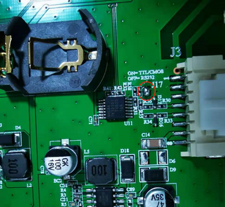

It should be noted that the default serial communication mode of the display screen is RS232, while STM32 serial communication mode is TTL communication mode. It is necessary to change the default communication mode of the display screen to TTL on the hardware. The modification method is as follows: use the solder wire in the figure for conducting.

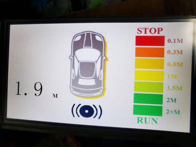

Step 6: Test Results
After the wiring is connected, the battery is energized for the test. The test results are shown in the figure and the effect is good.
