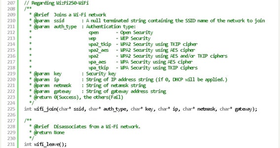

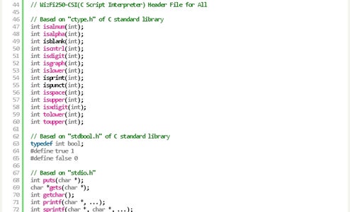

Step 1: Description of WizFi250-CSI.h
You can any script with this "WizFi250-CSI.h" file.
This header file include all API function which you can use for a script file.
For all "WizFi250-CSI.h", you can refer to the below link.
http://ilikethisplus.tistory.com/34
https://www.instructables.com/id/WizFi250-CSIC-Script-Interpreter-for-rapid-prototy/step2/WizFi250-CSIh/

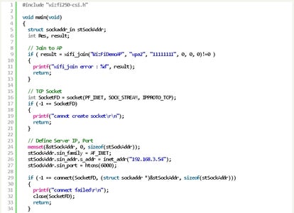

Step 2: Write "C Script File" for Serial-To-WiFi
Please refer to the below script file.
<p>#include "WizFi250-CSI.h"</p><p>void main(void)
  struct sockaddr_in stSockAddr;
  int Res, result;</p><p>  // Join to AP
  if ( result = wifi_join("WizFiDemoAP", "wpa2", "12345678", 0, 0, 0)!=0 )
    printf("wifi_join error : %d", result);
    return;
  }</p><p>  // TCP Socket
  int SocketFD = socket(PF_INET, SOCK_STREAM, IPPROTO_TCP);
  if (-1 == SocketFD)
    printf("cannot create socket\r\n");
    return;
  }</p><p>  // Define Server IP, Port
  memset(&stSockAddr, 0, sizeof(stSockAddr));
  stSockAddr.sin_family = AF_INET;
  stSockAddr.sin_addr.s_addr = inet_addr("192.168.3.54");
  stSockAddr.sin_port = htons(6000);</p><p>  if (-1 == connect(SocketFD, (struct sockaddr *)&stSockAddr, sizeof(stSockAddr)))
    printf("connect failed\r\n");
    close(SocketFD);
    return;
  }</p><p>  char szData[256];
  int length = 0;</p><p>  // Set GPIO12 input-pin.
  pinMode(GPIO12, 1);</p><p>  while(1)
    length = uart_rx(0, szData, 256);
    if ( length>0 )
      pinOut(GPIO12, 0);
      result = send(SocketFD, szData, length, 0);
      pinOut(GPIO12, 1);
      if ( result<0 )   break;
    }</p><p>    length = recv(SocketFD, szData, sizeof(szData), MSG_DONTWAIT);
    if ( length==0 )
      break;
    else if ( length<0 )
      if ( sock_error==EAGAIN )         continue;</p><p>      printf("<%d,%d>", length, sock_error);
      break;
    else
      pinOut(GPIO12, 0);
      uart_tx(0, szData, length);
      pinOut(GPIO12, 1);
    }</p><p>  }</p><p>  printf("Disconnected (%d) \r\n", length);
  close(SocketFD);</p><p>  return;
}</p>

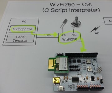

Step 3: Upload "C Script File" for Serial-To-WiFi
At first, you should upload(or write) script file as attached picture.
Step 4: Run "C Script File"
Now, if you reset the WizFi250-CSI, Serial-To-WiFi application will run as attached picture.
Data-communication worked well in both Serial-to-WiFi and WiFi-to-Serial.
