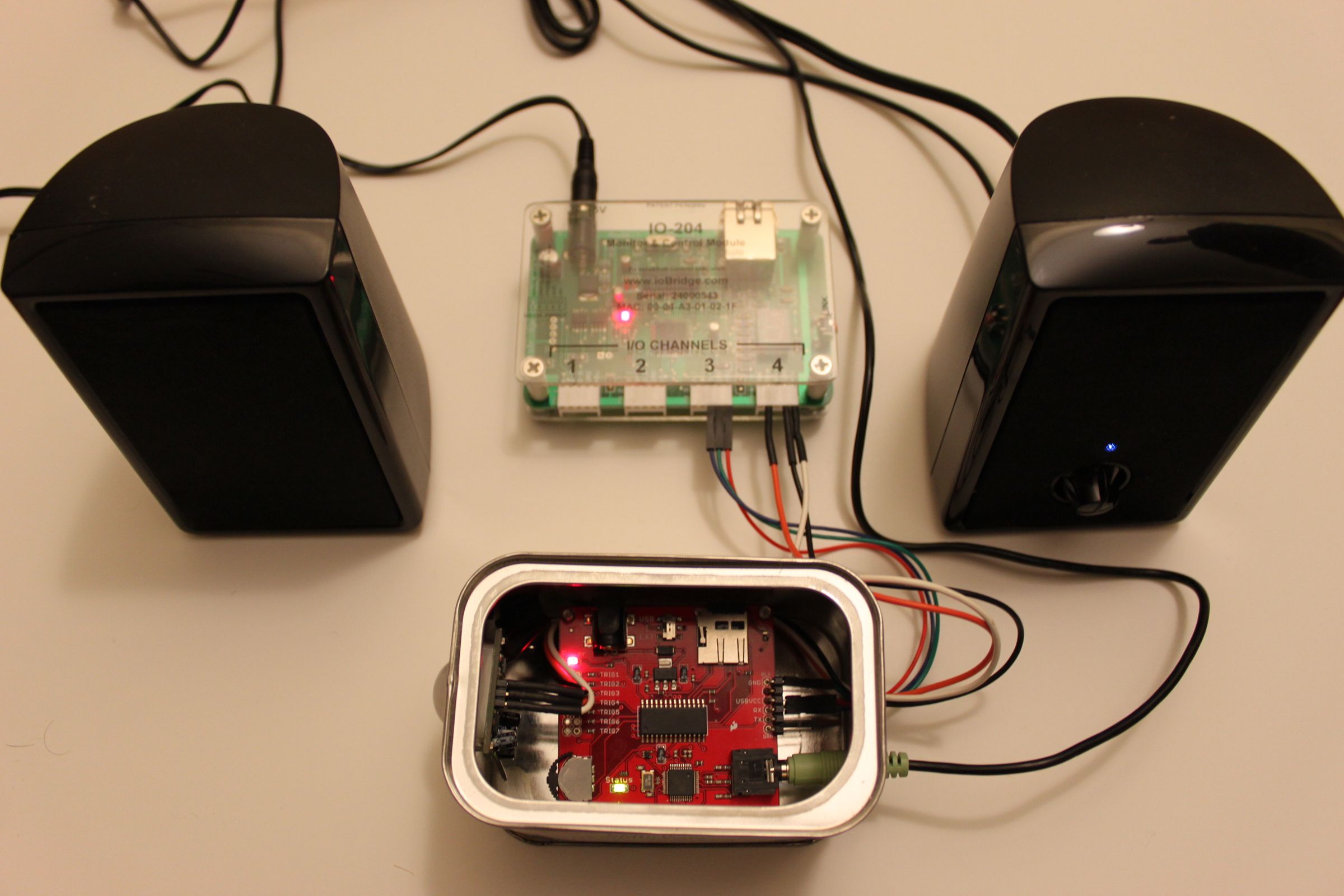

Step 4: Connect and Calibrate Servos
Connect the servo to the ioBridge servo module. Calibrate using the module page to find the positions of the servo for the start of the pour and the end of the pour. You will have to readjust positions when the full weight of the bottle and beer are in the housing. Careful not to push the servo past its limits.
