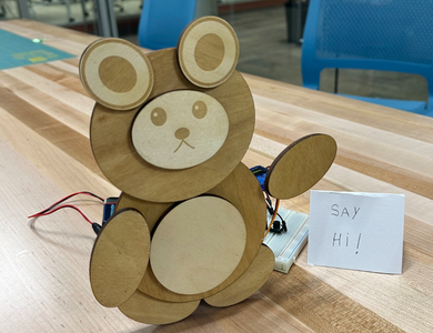

I started this project because I am new to Arduino and wanted to learn more about how servos worked but also to animate something that could be fun to display. I affectionately call it "Servo Bear".
He's a little layered wooden bear who waves “hello” whenever you press a button. The waving motion lasts for about ten seconds and has a surprisingly friendly feel to it. I added a small card next to him that says “Say Hi!”, partially inspired by the speaking tradition at my school, Washington & Lee, known as the “Say Hey” culture. People acknowledge each other on campus, even strangers. I wanted to turn that tradition into a physical interactive piece something that literally waves back.

Step 3: Layering & Gluing the Wooden Bear
Layer Order
Glue your layers in this order (back → front):
  1. Legs
  2. Main body
  3. Arms
  4. Belly
  5. Head
  6. Face oval
  7. Ears
I used wood glue for the structural layers so they bonded firmly, but used hot glue where I needed quick setting, especially around the servo.
Adding the Servo
  1. Position the servo behind the left arm
  2. Hot glue the servo horn directly to the underside of the arm.
  3. Then hot glue the servo body to the back of the main body layer, making sure it can freely swing about 70 degrees.
Because the servo sits on the back, all electronics stay hidden when viewed from the front.
Standing Support
I used some 3D printed scraps pieces that were lying around they worked quite well:
  1. One piece about 5 cm × 3 cm forms the base.
  2. Another piece about 2" × 1.5" acts as upper support.
Glue both to the bear’s back at slight angles until he stands comfortably.

Display
I placed a handwritten card next to mine that reads “Say Hi!”, connecting the project to the welcoming culture at W&L. It gives the piece personality and context.
The circuitry sits behind the bear, so from the front it looks like a small wooden character politely greeting you whenever you walk by.
It’s surprisingly endearing.
