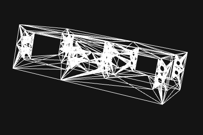

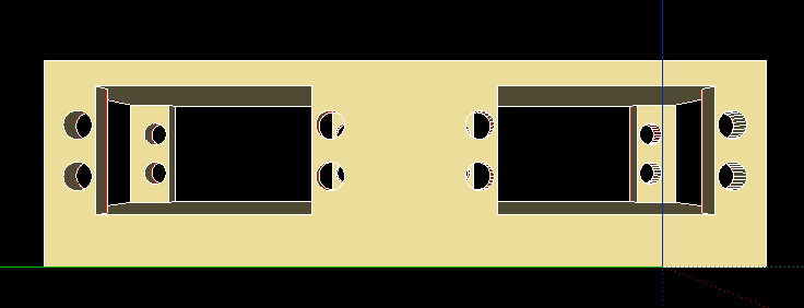

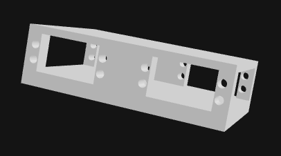

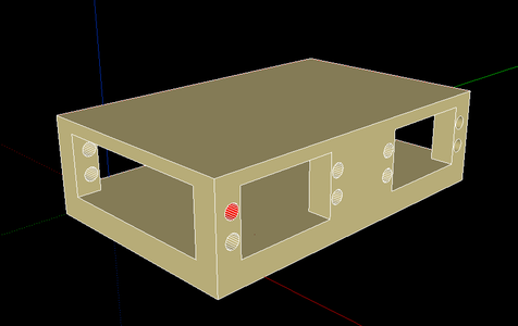

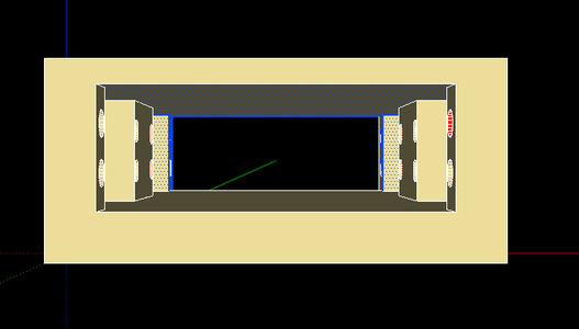

This is a 3D file created in Sketchup that provides a chassis for 4x Sparkfun Large Full Rotation Servos.
The dimensions are 14cm x 9cm x 4cm. The holes are meant for 4-40 screws.

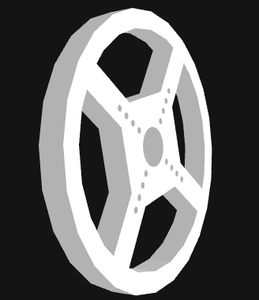

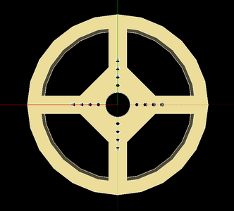

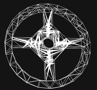

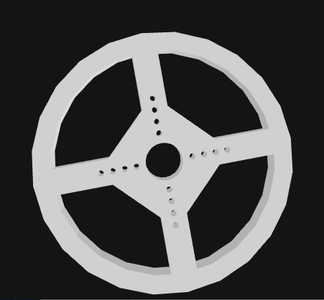

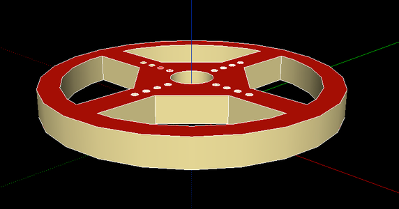

I am hoping to make wheels for it as well on a 3D printer instead of using standard servo wheels that you can buy.
The wheels attach to a servo horn instead of directly to the servo. It is 6.5mm wide with a diameter of 70mm (roughly 2.75inches).
The stl viewer is a new find that I really like. Check out Pleasant3D
The stl and skp files are attached in the zip file.
