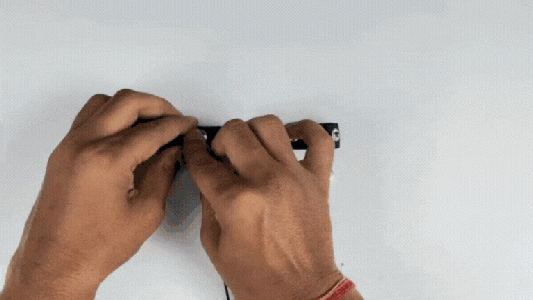

First of all, you have to assemble all the passive components on the Muscle BioAmp Shield PCB. For a step-by-step guide of the assembly, you can follow the video above or take a look at this interactive BOM.
Note: If you are getting the DIY Neuroscience Kit Pro, then it comes with the assembled version of Muscle BioAmp Shield. So you can skip this step in that case.

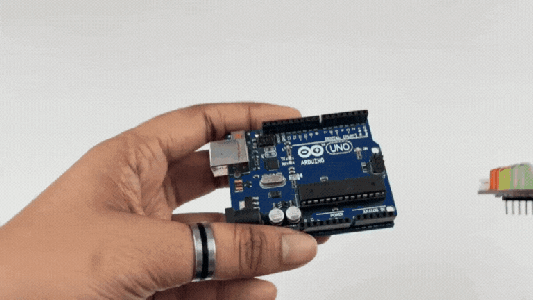

Step 2: Stacking on Arduino Uno
Stack the Muscle BioAmp Shield on top of Arduino Uno properly.

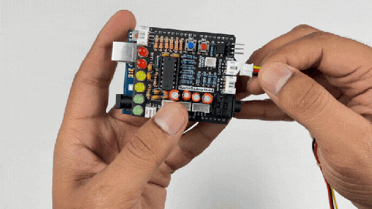

Step 3: Connecting Electrode Cable
Connect the BioAmp Cable to Muscle BioAmp Shield as shown in the connection diagram.

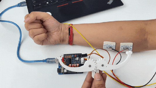

Step 5: Electrode Placements
We have 2 options to measure the EMG signals, either using the gel electrodes or using dry electrode based EMG band. You can try both of them one by one.

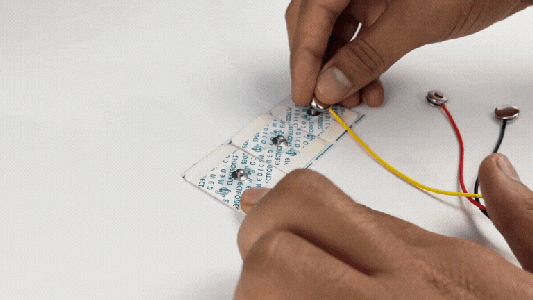

Measuring EMG using Gel electrodes:
  1. Connect the BioAmp Cable to gel electrodes,
  2. Peel the plastic backing from electrodes
  3. Place the IN+ and IN- cables on the arm near the ulnar nerve & REF (reference) at the back of your hand.
Measuring EMG using Muscle BioAmp Band, a dry electrode based EMG band:
  1. Connect the BioAmp Cable to Muscle BioAmp Band in a way such that IN+ and IN- are placed on the arm near the ulnar nerve & REF (reference) on the far side of the band.
  2. Now put a small drop of electrode gel between the skin and metallic part of BioAmp Cable to get the best results.

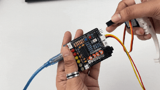

Step 7: Connect Servo Claw
Connect the servo claw to Muscle BioAmp Shield as shown in the video above.
