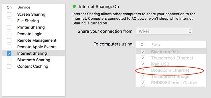

- Finally setup internet sharing on your computer allowing Broadcom Ethernet to connect to your WiFi via your computer.
