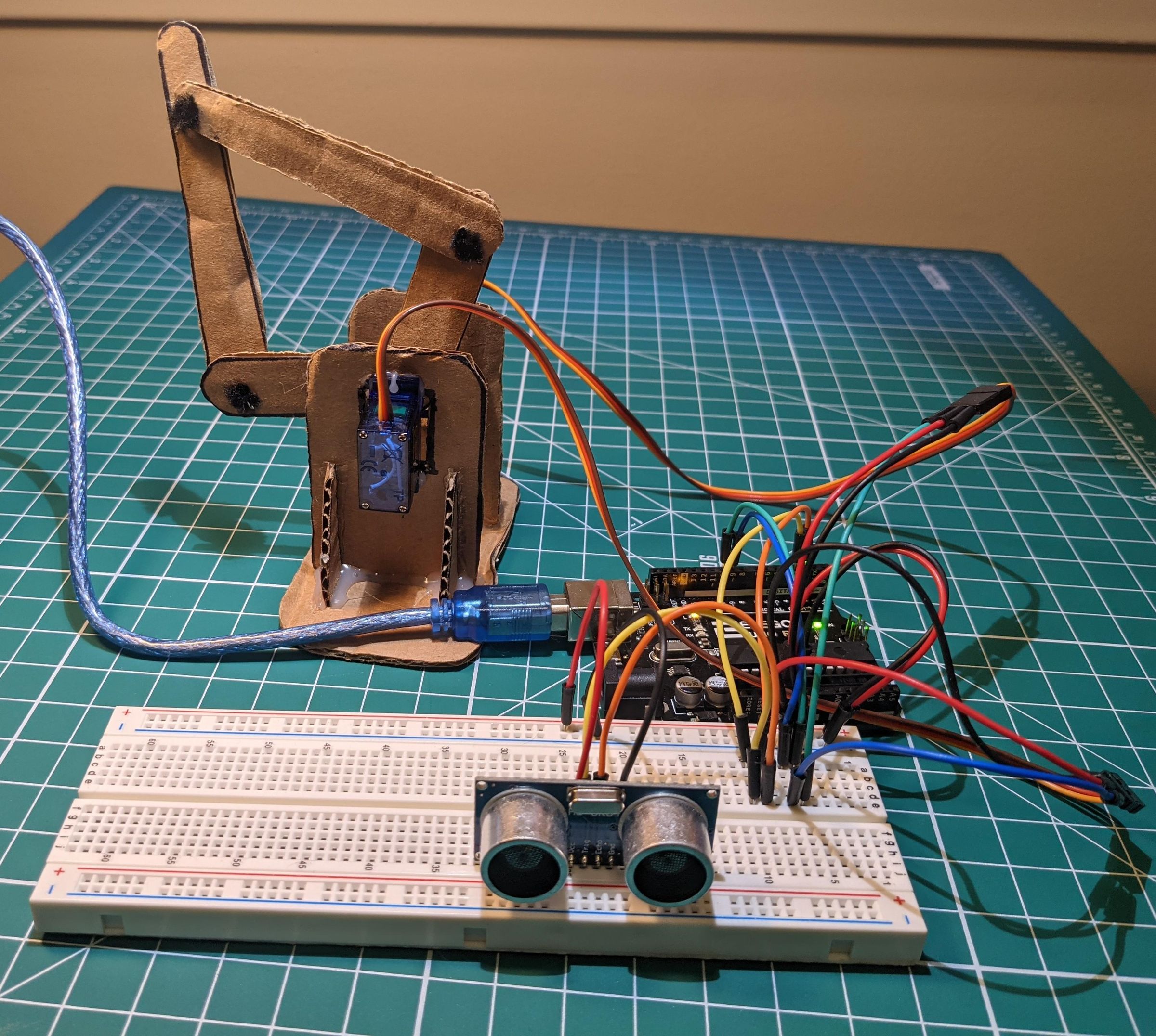

Step 5: Build the Servo Arm
With the creature decorated, the next step is to build the part that the servo will move. Go ahead and pull out your micro servo motor. In the bag with the servo, you should have received a couple of attachments that fit onto the motor. You can use any of these, but it will probably be easiest to use the one that attaches to the servo and only extends in one direction.
Apply hot glue to the top of the plastic piece. Use this to attach the small extra cardboard piece you cut out earlier to the servo. Be careful NOT to cover the screw hole, in case you need to make adjustments in the future (this is important, you will need to make adjustments). Then use the hot glue to attach that piece to the back of the creature part you will move.
Attach this piece to the servo, it should slide onto the white plastic end with the grooves.
Step 6: Test the Servo
You should now have a fully assembled servo attached to the creature part you will move. To test out the servo, pull out your Arduino Board, and open the Arduino IDE on your computer. In the Arduino IDE, hover your mouse over Tools > Board and ensure that “Arduino Uno” is selected. Then to open up the example sketch go to File > Examples > Servo and select Sweep.
Once the sketch is open, use a USB cable to connect your Arduino to your computer. Once plugged in, you will need to go to Tools > Port and select the COM port that corresponds to your Arduino. If there are multiple COM ports, one way to figure out which is yours is to unplug and plug the Arduino back in. See which port goes away and shows back up.
You can go ahead and press the circle with the right arrow in the top left corner to upload the Sweep sketch onto your board. This may take a few moments.
Once the code is uploaded, unplug your board from the computer, all of the lights should turn off.
Now we are going to connect the servo motor. We are going to use a breadboard for this so that it is easier to expand the project with more stuff in the future. Use the rails of the breadboard to connect the red wire of the servo to the 5 Volt, the Black Wire to Ground, and the yellow wire of the servo to the Digital 9 pin.
With these wires connected, you can plug the Arduino board back into the computer. Since the code is already loaded, once you plug it in, it should start to sweep the creature part back and forth right away. Depending upon how you placed the plastic part that secures to the servo, the part may start in an odd position. Try to change this by adjusting the piece.

You now have a moving part, and a fully decorated creature. Use hot glue to attach your servo to the main body of the creature so that the part will move as you intended.
Once in place, you can plug in the arduino to check that it moves correctly.
You can now also use the base, and extra cardboard you cut out, along with the hot glue to make your creature stand up on its own.

The last extension to this project will manually control your creature with a potentiometer. A potentiometer is a resistor with a sliding contact that serves as a voltage divider. This can indicate its current rotational position.
For this, we will change the sketch running on the Arduino. Open the Arduino IDE, hover your mouse over File > Examples > Servo and select Knob. Upload this new code to your Arduino.
Now make sure you unplug your Arduino while we change the circuit.
Pull out one of the potentiometers. Use alligator clips to connect to the metal leads sticking out of the potentiometer. You will want to use the black and red wires on the ends, and a different color (I used green) in the middle.
We will once again use the breadboard to connect the potentiometer to the Arduino. Connect the red alligator clip and wire to the 5 Volt rail on the breadboard, and the black clip and wire to the Ground rail. You will use the breadboard to connect the green clip and wire to the Analog 0 pin.
Now plug your Arduino back in. The servo may quickly move to the position the potentiometer is currently at. After that, you should be able to turn the potentiometer and see the creature move as you turn the knob.
