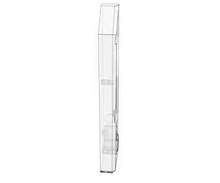

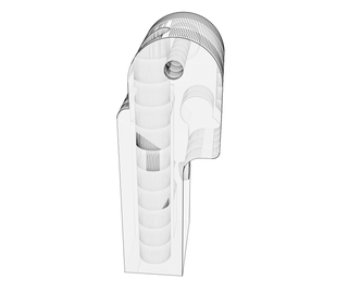

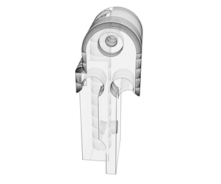

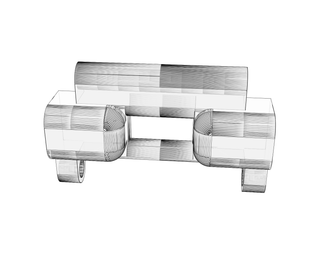

You need 33 track pieces per belt.

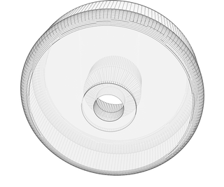

Step 4: Assembly

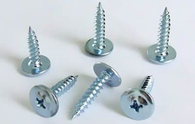

  1. Start by fasten the front to the middle part, use 2 self tapping screws and glue.
  2. Fasten servo with servohorn tap heading forward.
  3. Screw in the back parts thrught the hole in part.
  4. center and fasten the servohorn to gear, fasten gear to servo.
  5. screw on side skirts
  6. use 3mm filament, burn the end and stump them flat. do this at both sides, make it tight.
  7. Assembly bearings to back part, suspension pins and wheels.
  8. Sand suspension pins to fit the chassi, they have to turn pretty free. use grease.
  9. secure the back suspesion pin with a wide head screw.
  10. Fasten wheels to suspesion pins.
  11. Fasten back wheel (all wheels are assembled bearing turning out)
  12. Set in the springs, easiest if you set it in the chassi first.
  13. Assemble belt, use the filament trick. 33 tracks per belt. you can change belt tension by changing wheels to smaller or bigger ones. (depence on what springs you have)
  14. assembly the last track when belt is stretched on place, and last chain over the gear, makes it easier
  15. Ready to connect to RC, arduino or what ever you like :)
