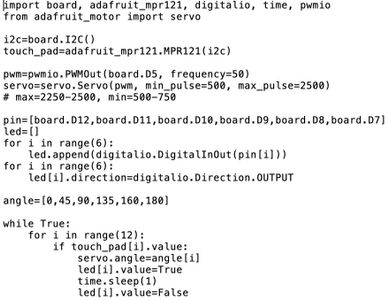

Step 5: Write Code
Create 3 lists for the buttons, lights and servo angles. Code for the press of a button to light the respective LED and turn the servo to the appropriate angle. Save the code on the CPB and replace computer cord with portable battery.
