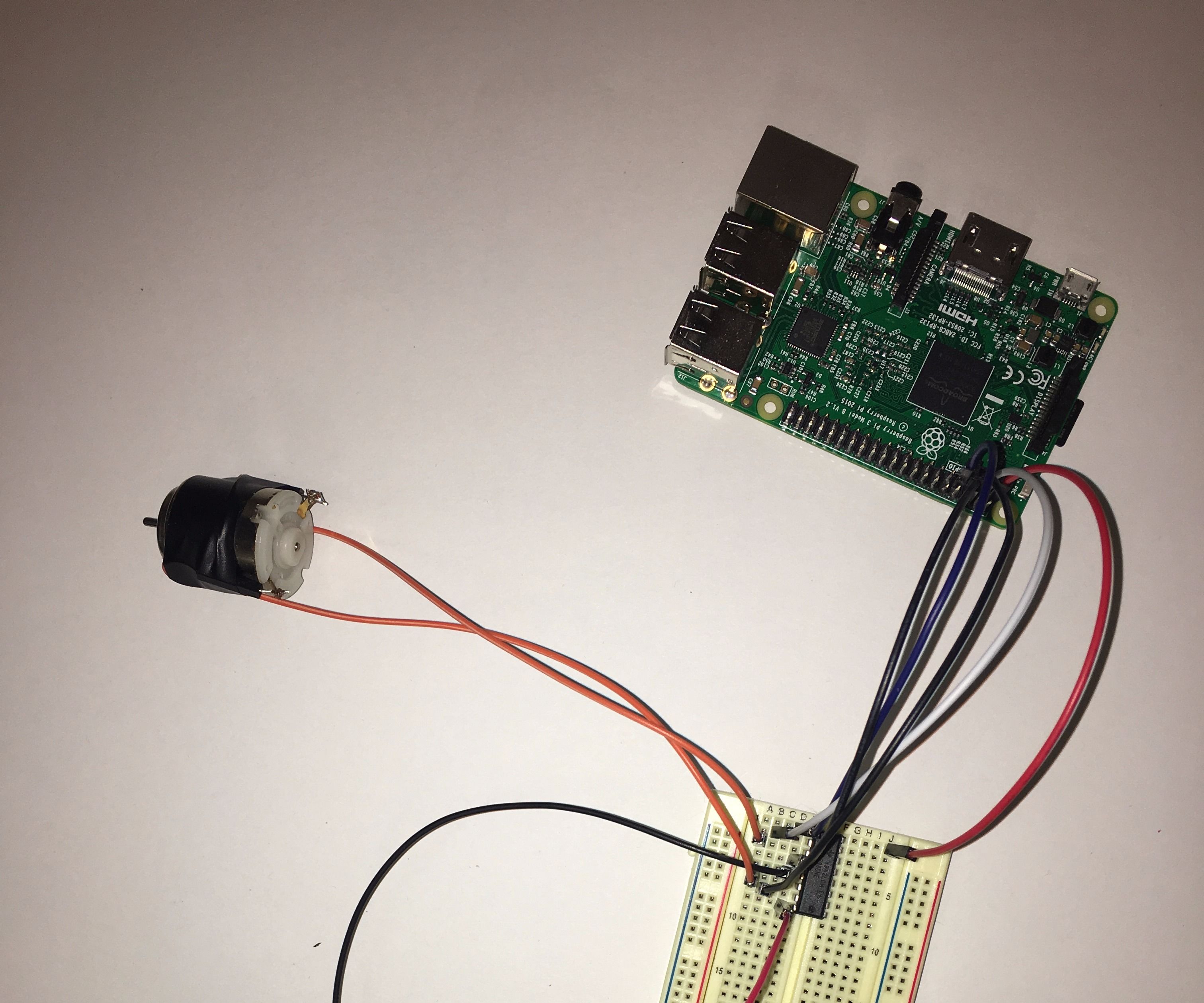

We'll be sending PWM signals from one GPIO pin on the RPi, and powering it from the GPIO board, so three wires will run from the servo to the RPi.
Now that we know what's going on, it's time to wire it up.
Step 3: Hardware Setup
The hardware for this project is very simple.
I recommend creating something to go on the end of the servo to better show its rotation, but that's totally unnecessary.
The only thing that you have to do is plug the three wires from the servo into the GPIO board. Refer to the diagram above for the pin numbers.
Plug a M/F jumper into each of the holes on the end of the servo cord, then plug the one coming off the red wire into pin #2, the one coming off of the brown into pin #6, and the one coming out of the yellow wire into pin #3. That's all there is to it, and if those instructions aren't clear enough, just look above at the pictures.
