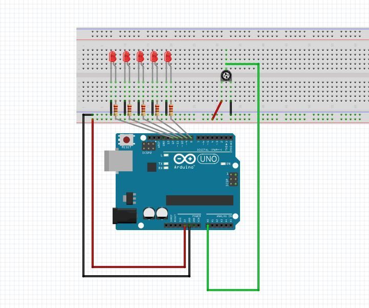

Step 1: Connect the Keypad
The keypad is pretty simple. Just connect pins left from right 8, 7, 6, 5, 4, 3, 2, 1. The picture is shifted by one but we are connecting the servo to 9 so just shift everything down.
