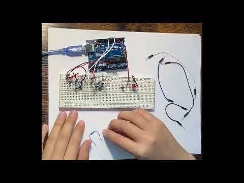

Step 1: Build Circuit
Diagram with Tinkercad below shows circuit layout

The angle is determined using a linear equation of angle (0-180 degrees for me) and the brightness based on what voltage is detected by the photoresistor (410-860 on the 0-1023 scale for me).
Step 3: Working Demonstration
