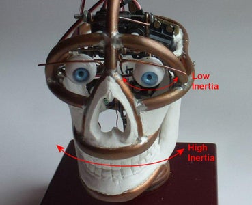

When you send a command to a servo, you're telling it where to go. A standard servo goes there as fast as it can. If it's driving a load with a lot of inertia - like turning the head in my android-head project - that can require a large torque which might damage the servo gears. When you try to stop the head turning, it could well overshoot leading to oscillation.
If I tell a robot arm to move the shoulder to angle A, the elbow to angle B and the wrist to angle C, then I'd like all the joints to arrive at their target at the same time The fingertips won't travel in a straight line but the line will be a lot straighter than if the joints move independently.
The "brain" of the robot (an ESP32cam in the android-head and the robot arm) sends target positions to the servo controller (an Arduino Nano) over a serial line and we want the controller Nano to make the servos go to that target in a sensible way.
Could you use a PID controller? In theory, a PID requires feedback from the servo - which we don't have. The arduino has no idea what the servo is actually doing. But we could assume that the servo is where the command pulses tell it to be. The drawback is that PIDs are notoriously difficult to "tune" - to find the right values of Kp, Ki and Kd parameters. The parameters depend on the inertia of the system and we don't know that. I've done PIDs for big industrial robots but they're overkill for a hobby project.
A compromise is to limit the maximum acceleration - amax - and maximum velocity - vmax - of the servo. It's a kludge but by choosing reasonable values for amax and vmax you can get the servo to behave reasonably under most circumstances.

A further problem comes when you have several servos. What you want is for them to act together. You want them all to arrive at their targets at the same time. But the servos might have different amax and vmax and will have different distances to travel to their targets. (I'll assume that when they reach their target they come to rest.) I can find nothing on the web about multiple servos acting together - either with PIDs or ramping.
In the case of a head, the eyes have high vmax and amax while turning the head has low vmax and amax. A robot arm will have higher vmax and amax at the elbow than at the shoulder and higher still at the wrist. If the head is not moving then the eyes can move fast but if the head and eyes are simultaneously to given targets, you want both to arrive at their target at the same time as though the eyes were tracking the target (neither the Nano nor the ESP32cam can do real-time visual tracking).
If all the servos start at rest, it's not too difficult to get them to act together. But it they're already moving when a new target command arrives and the servos have different amax and vmax then there is no "correct" solution. I tried a large variety of different algorithms and all had faults. I can't find any papers on the subject.

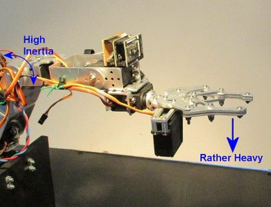

Similarly in a robot arm, there is a group of
  • shoulder left/right
  • shoulder up/down
  • elbow up/down
  • wrist up/down
But these servos move independently:
  • hand rotate
  • fingers open/close

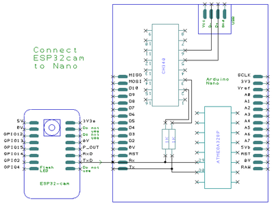

But in this project, I'm assuming that the Nano is a dumb servo controller that receives serial commands from a master processor.
Step 3: Serial Commands
In the attached code, the Nano receives commands through its serial port. Commands consist of a low byte and a high byte. The bits of those bytes are

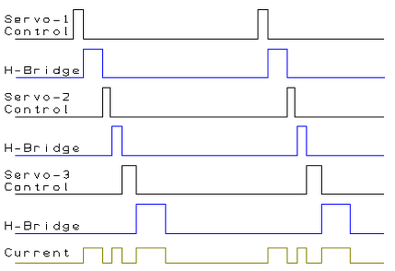

Standard servos receive command pulses 1mS to 2mS long every 20mS (or maybe 0.6mS to 2.4mS depending on the model). There's a potentiometer which measures the position of the output shaft. There's then some analogue electronics which outputs pulses to an H-bridge controlling the motor. The width (and direction) of the H-bridge pulse depends on the width of the command pulse compared with the output from the potentiometer. It used to be done with 1960selectronics - quite clever. Of course, there are now chips like the AA51880 or the M51660 or the CMT5188.)
The 20mS gap between pulses allows the electronics to recover: I suppose a capacitor is recharging or something. (There are more modern "digital" servos that have different electronics. What I'm describing doesn't apply to them.)
There's one H-bridge motor pulse per command pulse. The H-bridge pulse starts when the command pulse stops. No-one seems to realise that. I've searched the web and I can't find it discussed anywhere. It has two consequences:
If you stop sending pulses, the servo "relaxes". It's as though the servo is switched off. The motor stops straining and you can back-drive it (maybe - take care). That's useful for robots. To save power, you don't have to switch off the power to the servos, just stop sending them pulses. The standby current is a few mA.

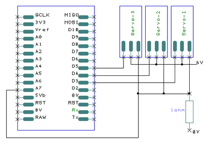

Secondly, it you measure the width of the H-bridge pulses, you can tell how hard a servo is working.
When you're developing a robot, you often get the commands wrong and the robot starts trying to destroy itself - they strip the teeth from the servo gears or break limbs. You can measure the H-bridge pulse width via a 1ohm resistor in the servo's power wire - either the 0V or 5V wire. The easiest way to see the pulse is with an Adruino's ADC. You don't measure the height of the pulse, just its width. So if the robot's legs are jammed, the H-bridge pulse might be (e.g.) more than 5mS long for 3 consecutive pulses. If you see that, stop sending servo pulses. I've saved several servos and robots that way.
If you're controlling, e.g., six servos, you will want to measure each one's H-bridge pulse individually. You could put a 1ohm resistor in the power line of each servo - that's six resistors going into 6 ADCs - a lot of pins.
Or you could use one resistor for all of them. Use a bit-banged pulse generator rather than Servo.h library. Send a command pulse to the first servo using
       digitalWrite(ServoPin,HIGH);
       delayMicroseconds(Position);
       digitalWrite(ServoPin,LOW);
Wait a few microseconds (0.2mS maybe) so the H-bridge will have gone high and time how long until the H-bridge goes low.
       delayMicroseconds(200);
       measure time until current goes low.
 Then move on to the next servo and do it again. Visit each servo in a round-robin. I've managed to control 8 servos that way. If you need more servos, the loop gets too long (more than 20mS) and you'll need a second resistor and ADC. Or preferably a second microprocessors - processors are cheap.

The right way to control a robot's joint is to use a PID. The processor always knows the current joint angle and the PID is tuned to the mechanics of the robot. That's the way "real" robots do it. They also do inverse kinematics and force-feedback and so on. If you're using hobby servos, you can do none of that. Measuring the H-bridge pulse-width gives you some idea of the force but not enough to do feedback-control.
If your robot has inertia then you need to start its movement slowly - the servo's velocity should ramp up - so as not to damage the servo's gears. Once it's moving, the robot will have momentum so you should bring it to rest by ramping down the velocity. If you don't ramp down, the joint will overshoot, the servo will correct itself and start oscillating. If the robot is holding a heavy weight then oscillation will be even more likely. In the cheap robot arm shown above, I've added damping washers to reduce oscillation.
