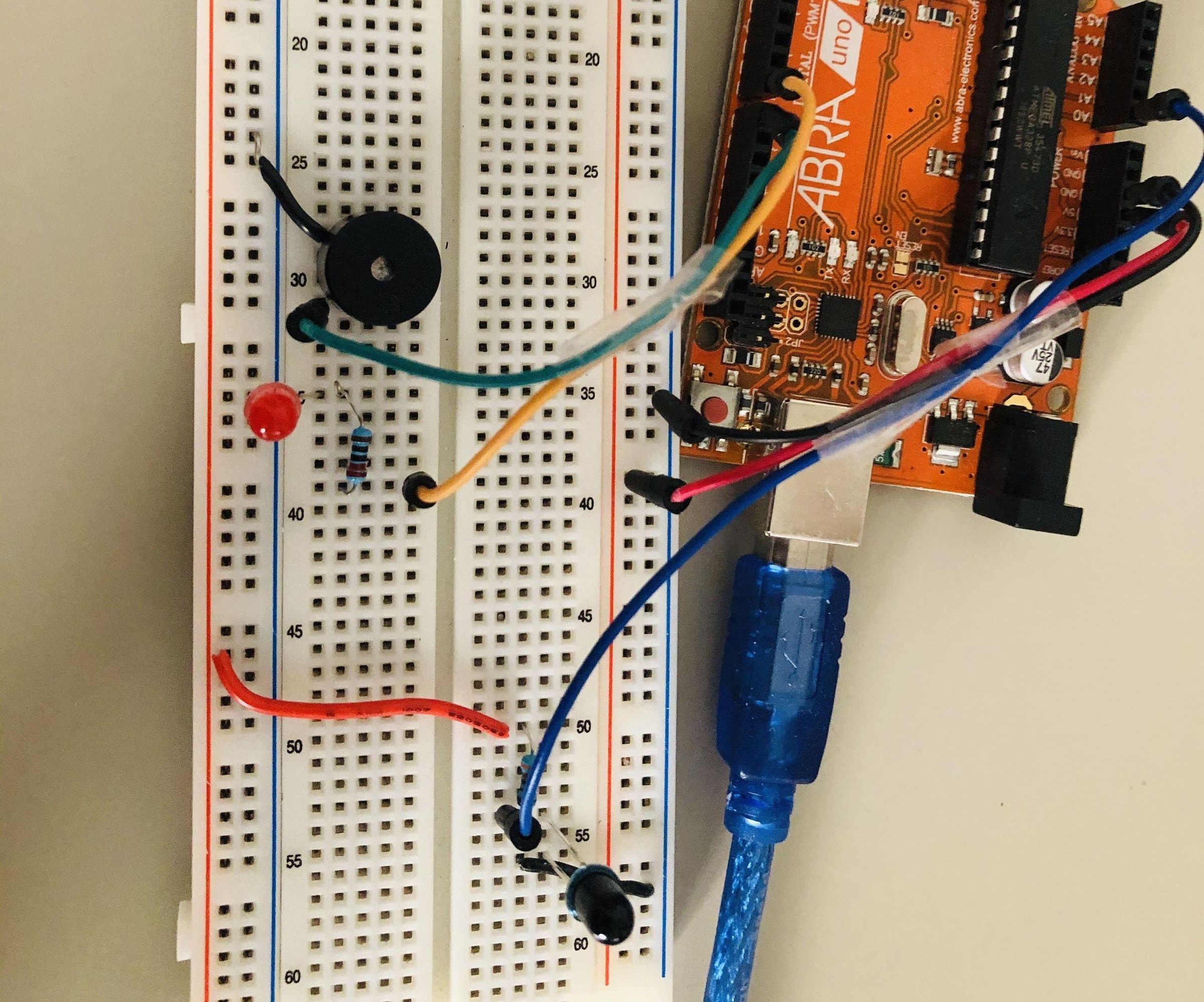

Step 3: Step 3: Wiring
Now it's time to wire. The wiring is very straight forward. A servo has three connections; ground, power, and digital pin. Using jumper wires to connect each one of the servos to a power and ground pin on the breadboard. Make sure that the power rail is connected to 5V on the Arduino and the Ground rail is connected to GND on the Arduino.
1st Servo
  • Connect to Digital Pin 3
2nd Servo
  • Connect to Digital Pin 5
3rd Servo
  • Connect to Digital Pin 6
4th Servo
  • Connect to Digital Pin 11
