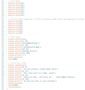

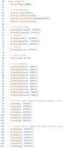

Step 7: Setup Function Code
Sets up all of the Inputs/Outputs
Displays the Start Screen and the Instructions Screen

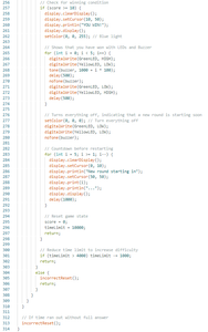

Step 9: Game Logic Functions
This section contains all the main game functions that handle generating questions, checking answers, displaying feedback, controlling LEDs, servos, sounds, and the Seven-Segment displays.
Each function is already fully commented in the code to explain its purpose and how it works.
